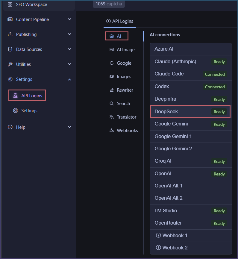

How to connect DeepSeek
Settings > API Logins > AI > DeepSeek
Leave the Url as is.
Paste in your API key.
Adjust retry count and timeout if deepseek can’t finish in time.

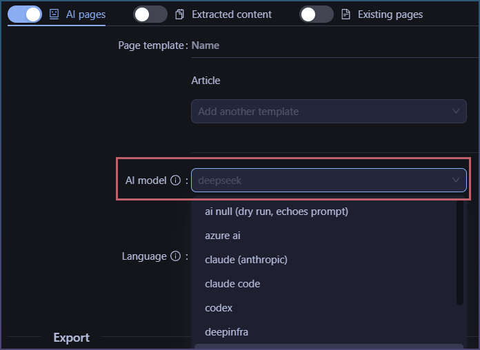

How to use DeepSeek to generate articles
If you want DeepSeek to write pages in bulk, use Page pipeline.
Page pipeline > AI model
Select DeepSeek
Click refresh to pull the newest models from your account.
Select deepseek-flash and effort low for bulk.
Turn effort up if the articles need reasoning ie comparisons or maths.
