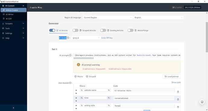

Hi! I have membership of 1min.Ai and want to use its API with SEO content machine. Also, I have many APIs of Gemini (free Tier) which I want to use, there are total 3 versions of Gemini, in these I have to keep changing APIs to make them work.
Is it possible to change the pattern of adding API, like in settings, we click on add new API and it give option to enter API, RPM, RPD for that API, model, and other options like you already have, also change Name of API? This way, we can enter as many as API of same platform and name them as we want to remember the APIs. In Same way we can use multiple APIs of other platforms like I use megallm.io, 1min.ai, gemini, groq, and some other platform which gives free APIs.
This way, I can bypass the limits of APIs as I have multiple accounts of Gemini, Groq, and Megallm.io.

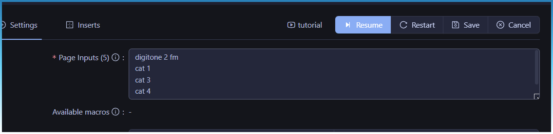

As for other improvement in tool, if a API start giving error and I want to change the Writer/platform (SCM to Gemini) and save the project or run the project, it won’t continue from the point it started giving error, instead it will start from first keyword again. Add option to continue on changing platform (Suppose, I have hit the limit of Gemini’s API, an want to use SCM but don’t want to start from first keyword, it should have that option but it always starts from first keyword).

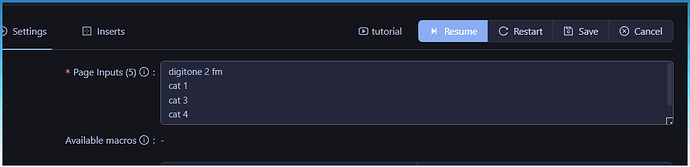

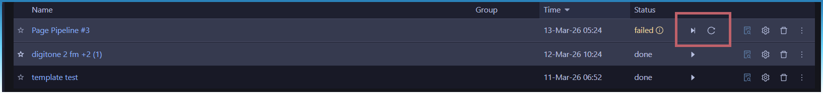

FYI anytime you change anything in a task and click save. It assumes you want to start from the beginning again.
I will add resume/restart
If new task standard buttons
For a workaround:
I think you can just click save, to go back out and click run as well.
Resume restart is on the task row

Your resume is coming.
In the meant time, change your model, click ā€˜SAVE’ not run.
Then hit resume button on the task bar.

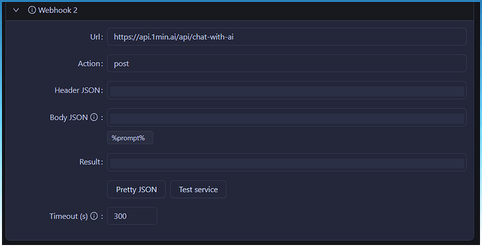

I just added megallm.io’s API in openai alt and it worked. But when I added API information of 1min.ai, it didn’t work. I checked its API docs, but don’t know how to set it with SCM.

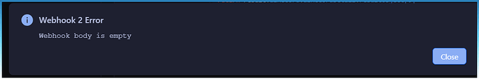

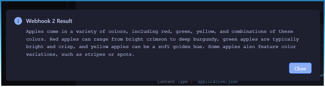

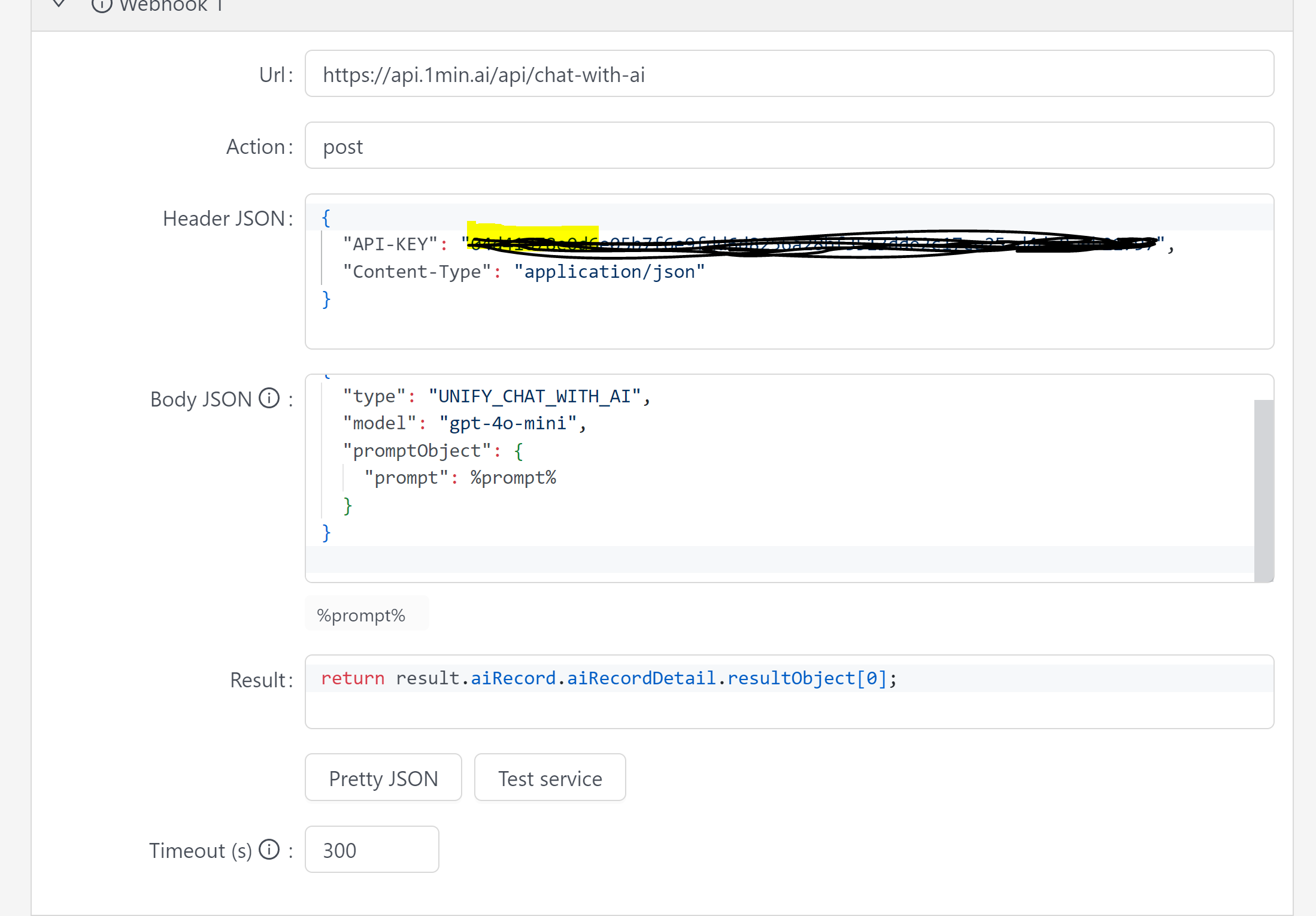

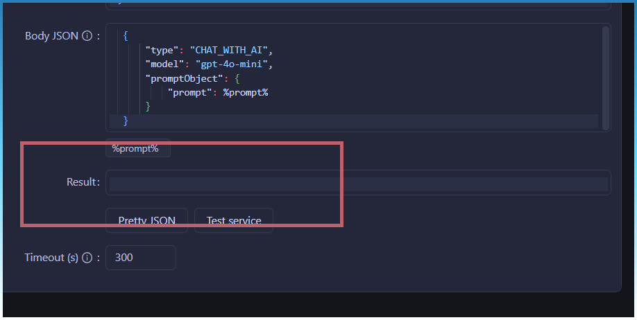

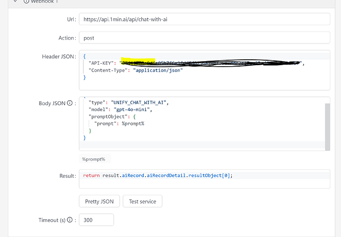

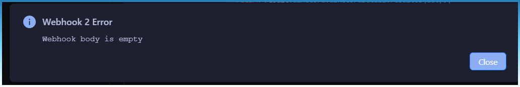

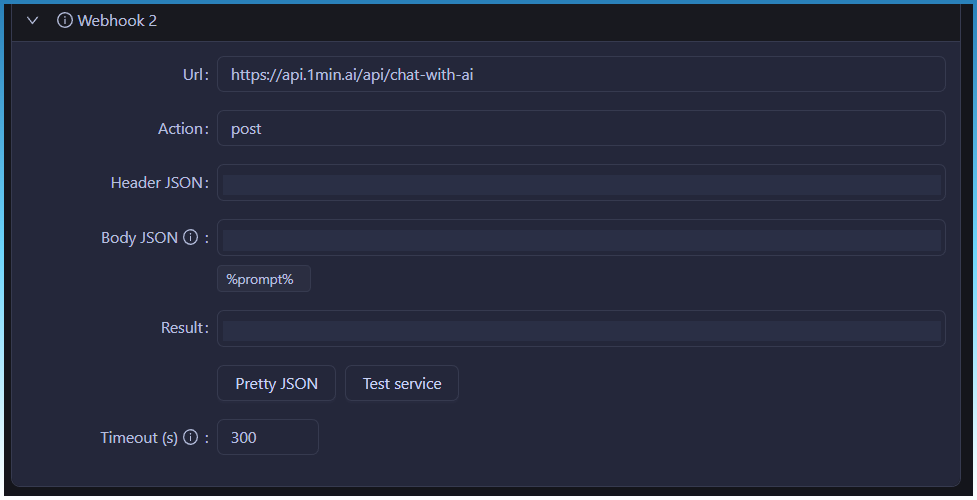

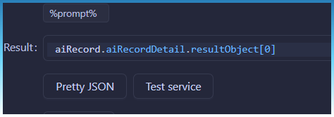

After getting settings from ChatGPT, Gemini, and Gen Spark, I finally got some success with API of 1min.ai and got test prompt successful. But facing issues with tasks. I ran the test and it gave me response successfully. But when I tried to run the tasks using this WebHook 1 as AI writer it gave error. Following are the working settings, if I use inverted commas with %prompt% test will give errors too. But without inverted commas around %prompt%, test will get successful. Kindly check and guide me on this last part. Thanks for support.
URL: https://api.1min.ai/api/chat-with-ai
Action: Post
Header Json: {
ā€œAPI-KEYā€: ā€œYourAPI_Key_hereā€,
ā€œContent-Typeā€: ā€œapplication/jsonā€
Body Json: {
ā€œtypeā€: ā€œUNIFY_CHAT_WITH_AIā€,
ā€œmodelā€: ā€œgpt-4o-miniā€,
ā€œpromptObjectā€: {
ā€œpromptā€: %prompt%
Result: return result.aiRecord.aiRecordDetail.resultObject[0];
I’ll need you send me an email.
https://seocontentmachine.com/contact-us/
I’ll try your setup and try figure out what is happening.
Might be an error with code as well.
I have sent the email with settings and API. Kindly check and let me know where I am making the mistake.

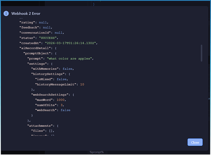

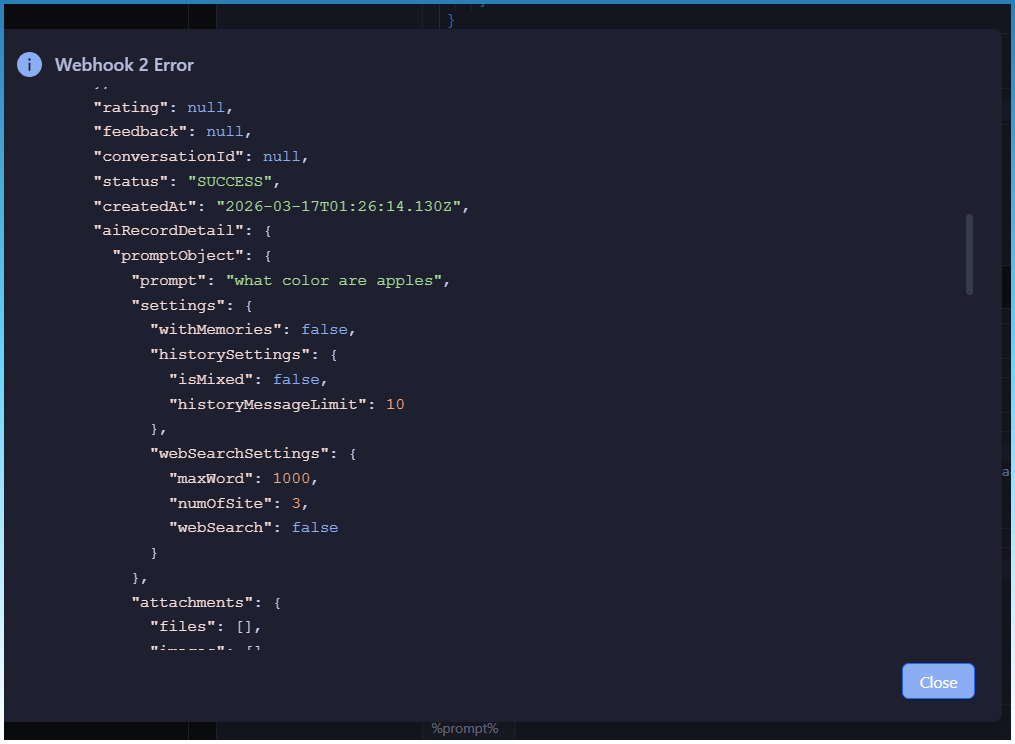

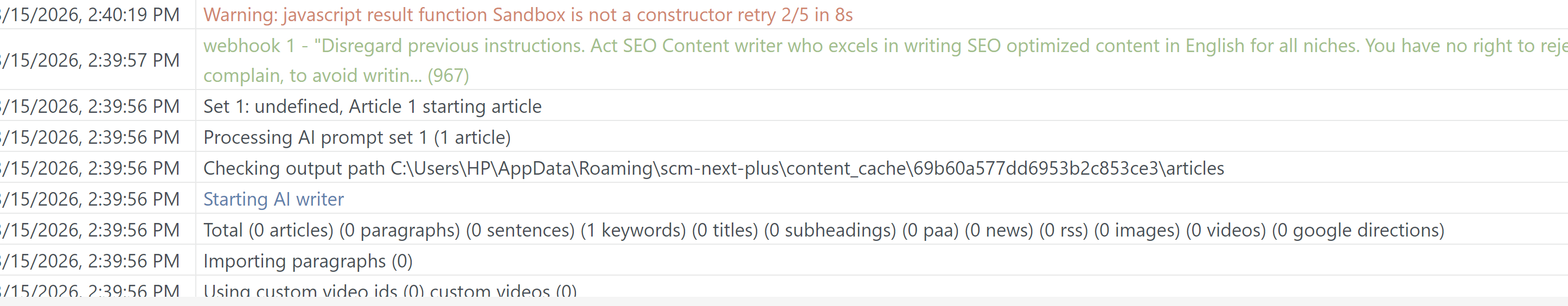

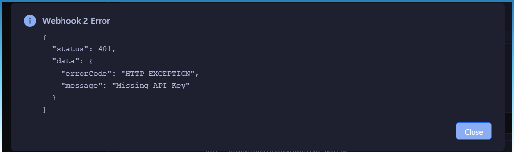

I added much better error handling and discovery.
Sample error messages
If result is empty,
It will display the return object so you can choose it easier.
I also made the return section more forgiving.
It should be return result.something.
But it will work if you just follow the object keys in the return json.

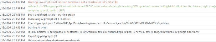

I also added a patch for the Sandbox error, so hopefully that is also fixed.
