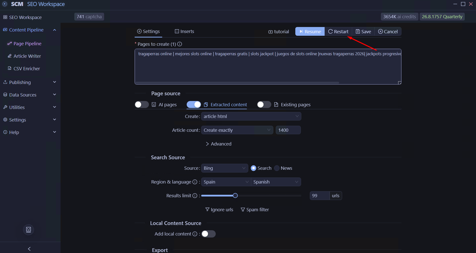

Hi. I copy the current project into the machine to edit it and create a new one, but after filling it with new data and clicking “Restart,” everything seems to freeze and stops responding to any input. I have to wait about 3 minutes until it sort of starts returning to the main screen, and after another pause, the generation begins. But the last time, it just crashed and shut down the machine completely. After that, all the progress in the generation process is lost, and I get a “failed” message. I don’t know if the problem is how I’m working or if it’s something else, but I’d really appreciate some help with this. What could be the cause, and what should I do to prevent this from happening?

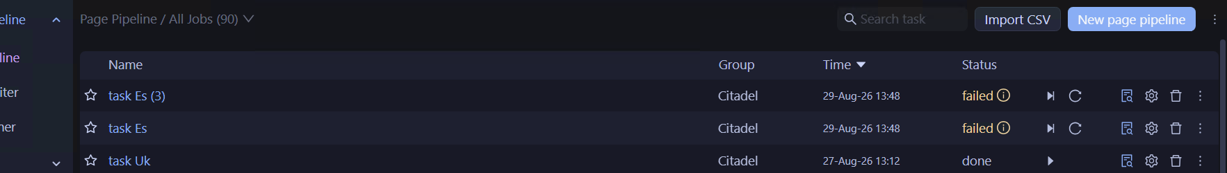

Something similar just happened. The content machine shut down on its own, even though it was open and the task was running; now it shows a “failed” status after being restarted.
I created a new task, and once again, SCM closed on its own without me doing anything

If it’s page pipeline my guess is a mem overflow.
I noticed you stuck in 10-15 keywords in one scrape and there is no cap to content kept in memory.
The keyword | keyword downloads and keeps all content in memory with no cap.
Error looks like related to the browser windows opening and then crashing when trying to close it.
Ill have a patch for you shortly, try that and report if it fixed it or not.
