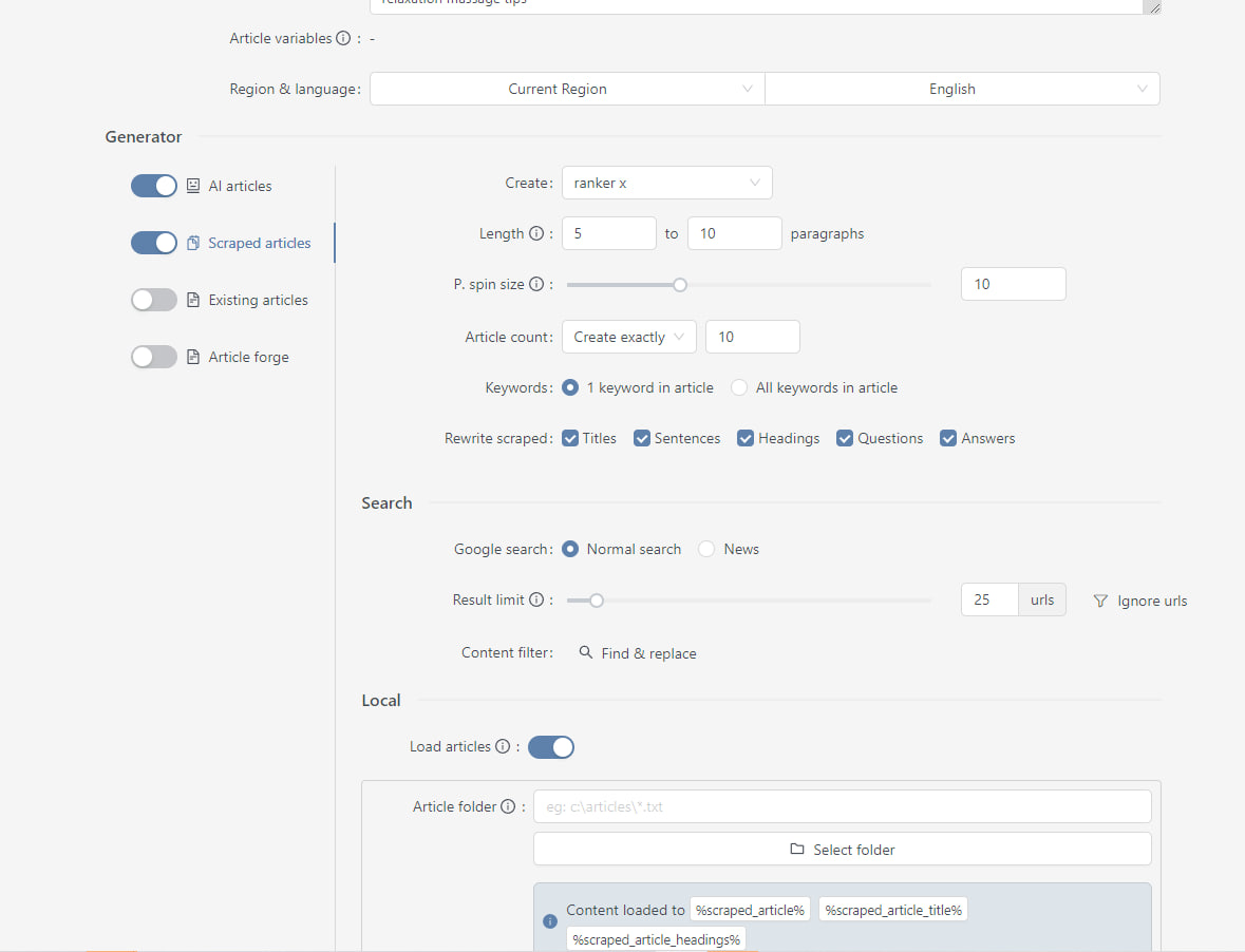

Created Bulk Files Using "Create: RankerX" for RankerX, But First Line Title Issue Wasted All My Credits

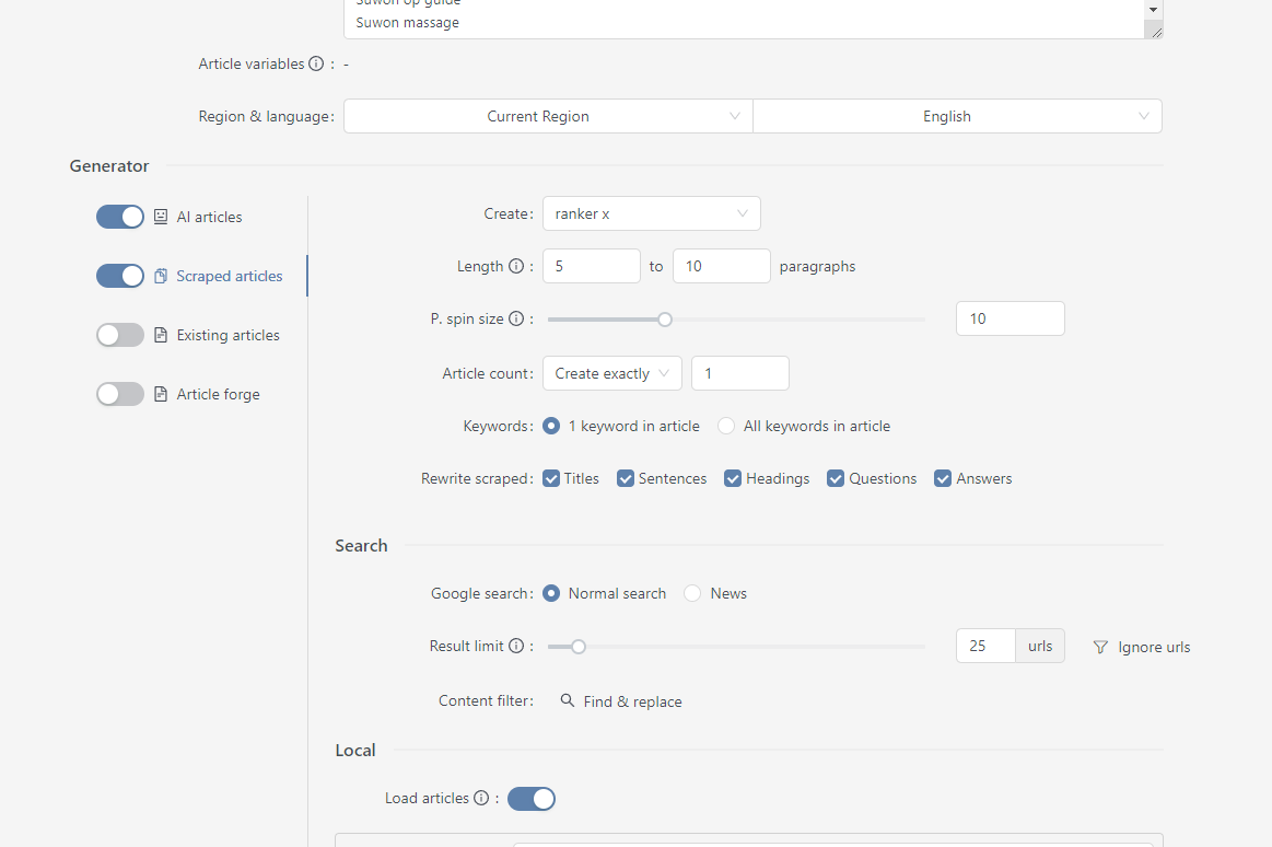

I selected “Create: RankerX” in SEO Content Machine to generate content for RankerX and created files in bulk.
However, RankerX interprets the first line of each article as the title, so the first line should contain a proper spun title.
But the generated files came out completely wrong — no valid titles in the first line.
As a result, I completely wasted two SCM AI Writer Starter subscriptions ($9.00 each / 750,000 credits) — all the content is unusable.
:backhand_index_pointing_right: How exactly should I set up the generation so that the first line contains a proper spun title for RankerX?
I’d appreciate clear guidance. Thank you.

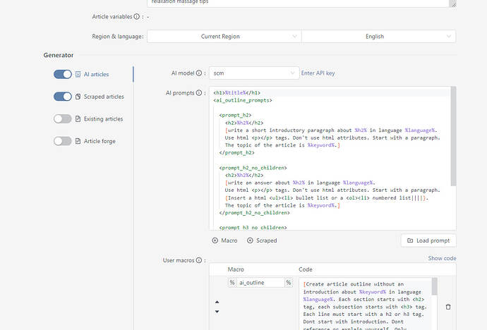

Your ai articles have h1 in the first line.
The scraped articles are in a spun format.
You have 2 different sets of articles.
One set is scraped content using ranker x template.
The other set is ai article using outline.
You just need to separate them.
Which should be easy enough because they are numbered in order.

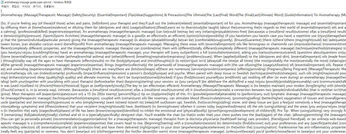

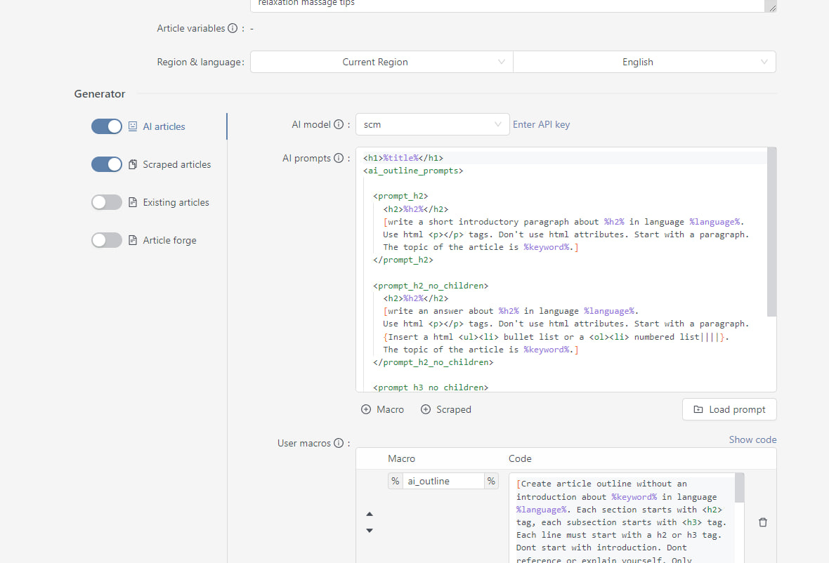

  1. AI credits used because you selected AI articles.
  2. AI credits not used on the rankerx templates

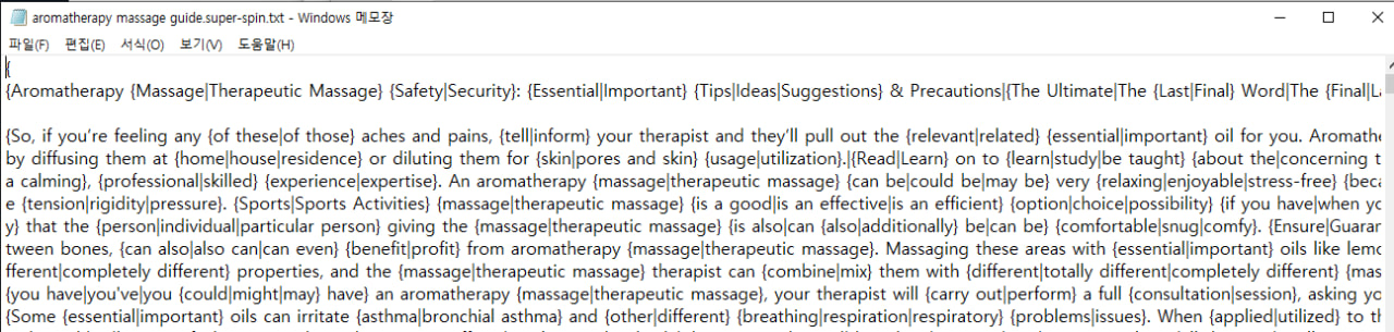

I figure out why the formatting is like that for both articles.

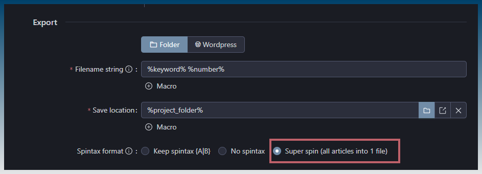

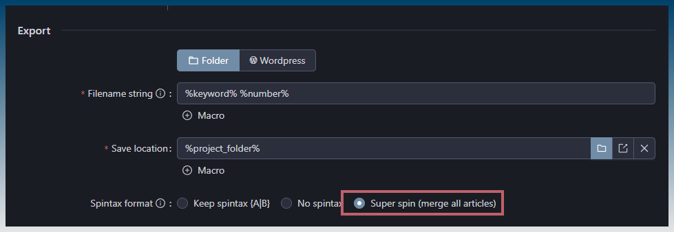

Its because you used the super spin function.
What this does is take the output of all articles, and combines them into 1 spin block.
Which won’t work as the first line is the spintax symbol.

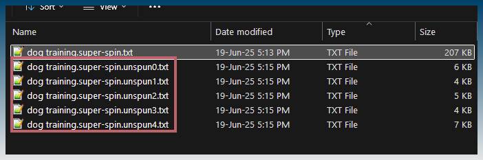

So what we need to do is un-spin all the articles one level deep into its own file. ie undo the super spun.

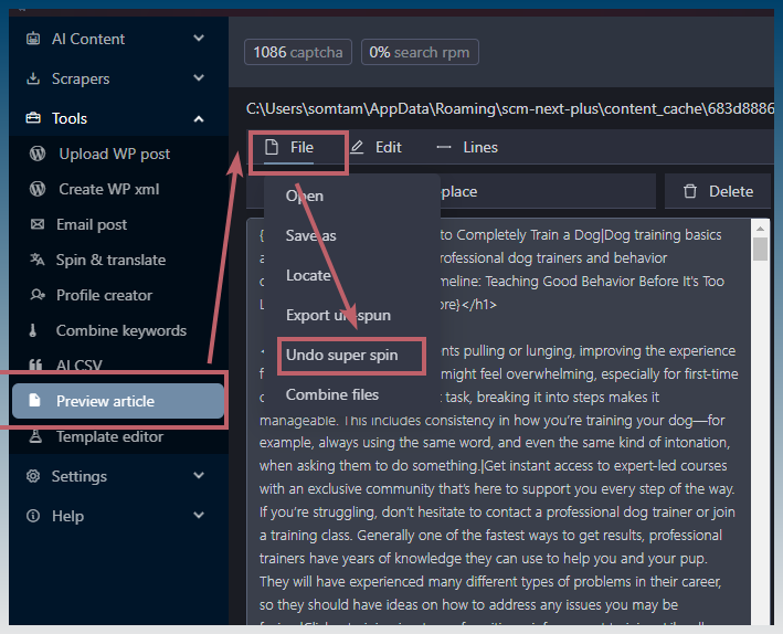

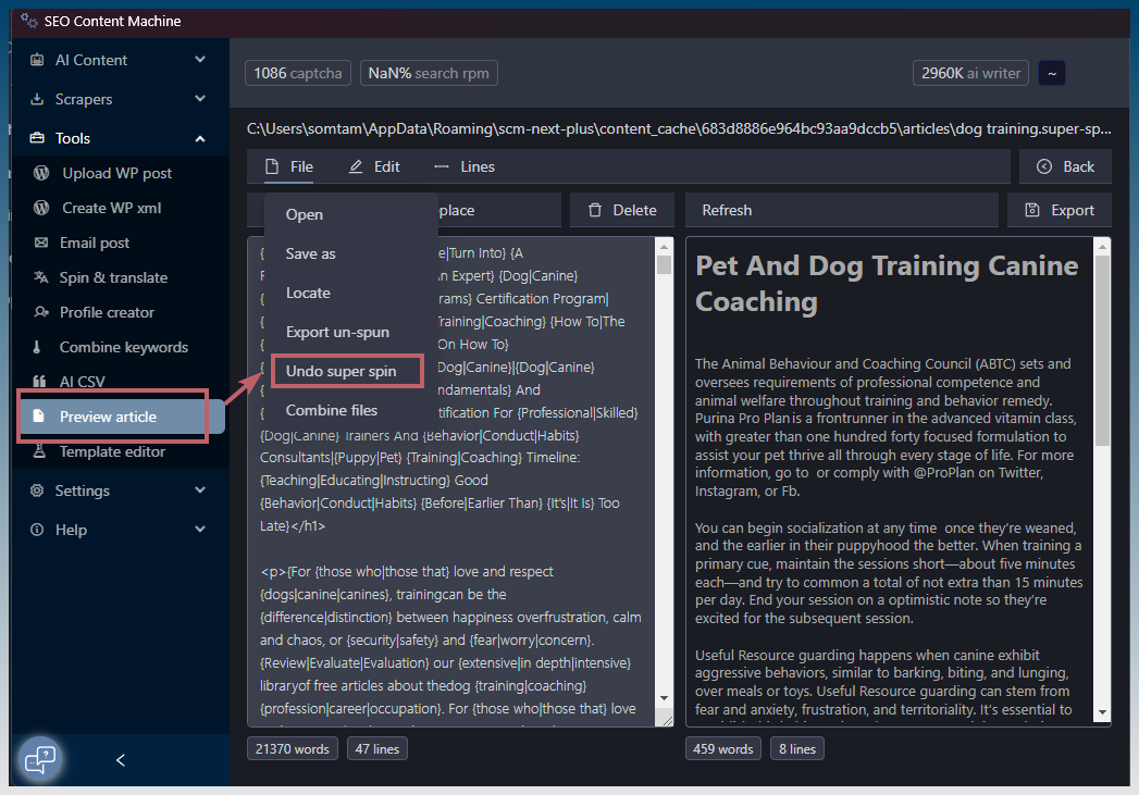

Ok, so I added new command in article preview window to undo a super spun operation.
I’ve checked everything. However, I need to use spin syntax, so do I need to regenerate the content?
I’m planning to generate 10 articles per keyword and use them in RankerX.
Spin is essential for this process.
But when I used the feature, all the spin syntax disappeared.
Unfortunately to take it apart you lose all spintax.
But it’s not a problem as you can use spin and translate tool to spin them again.
No need to regenerate them.
Yes, thank you. But when generating new articles for RankerX, if I choose “Keep Spintax” instead of “Super Spin,” will the output still be generated correctly?
Yes leave it as keep spintax.

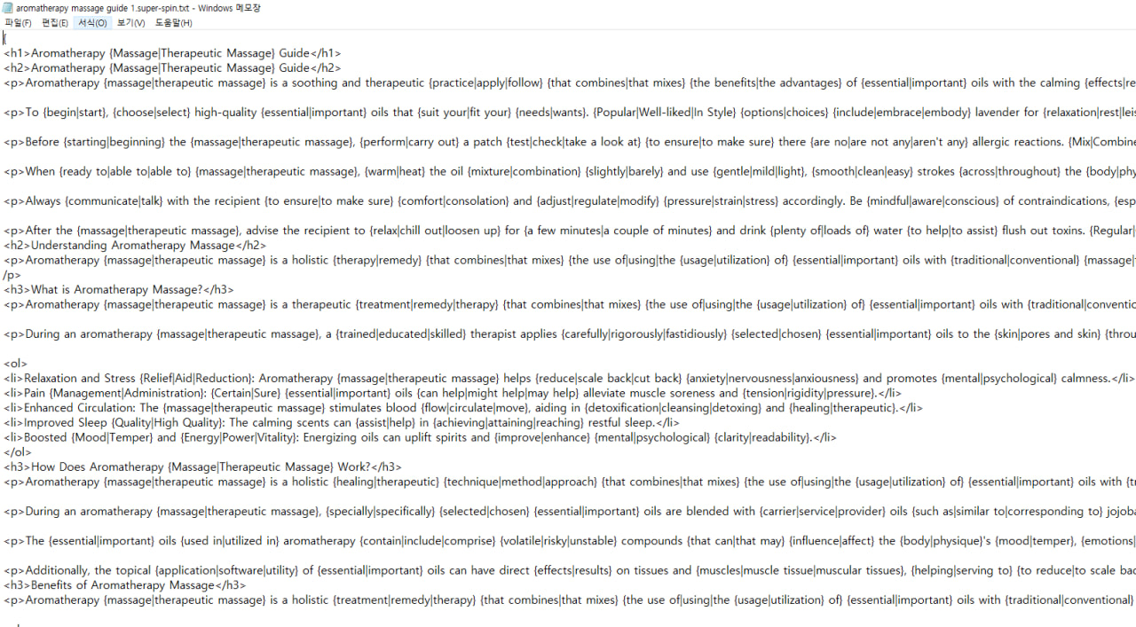

It will come out as normal spun content.
I also fixed the bug with super spun inserting extra line breaks, giving that blank line at the top of the article.
So even if you do super spun, you can correctly import it into rankerx.

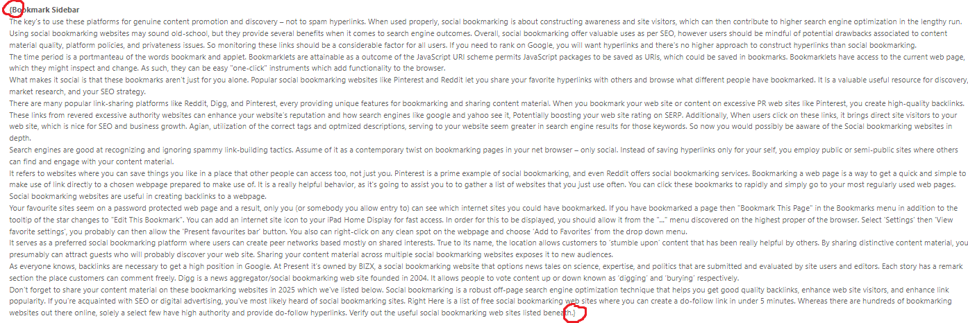

I’m still getting errors with the content I generate using SuperSpin.

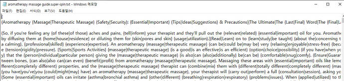

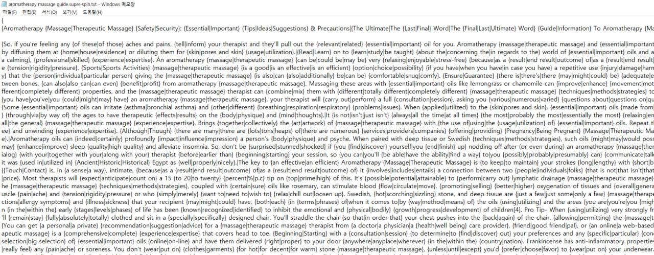

After looking closely, I realized the problem happens because an extra { gets added at the beginning of the first line (the title section), and an extra } gets added at the very end of the body content.
So whenever I generate content with SuperSpin and copy it directly into Notepad for RankerX, I always have to manually delete the { at the start of the title and the } at the end of the body.
It seems like the issue is that the title and body should be separated, but since they aren’t, an extra { at the beginning and } at the end get added, causing this problem.
How can I fix this?
Are you using the AI to generate content?
I did find a bug where if you only created 1 article but selected super spun you got the extra {}
I’m using it after setting it up like this
When will it be fixed? I have to create a lot of content, but it’s still a birthplace because of this
Super spin doesn’t do anything if you just create 1 article.
So turn it off by setting to normal spin output.
