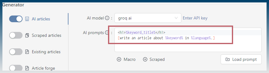

Threading right now is for prompts in 1 article.
How did you setup your tasks?
Eg
10 keywords
1 article per keyword
1 prompt per article?

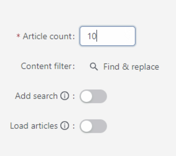

The working environment is set to generate 10 articles per keyword.

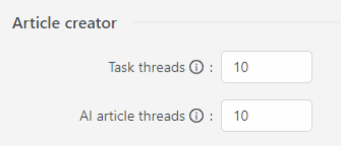

I have been using 10 threads for article writing without any issues until now. However, after the recent update, it is no longer working. Please check. The AI I used is OpenAI.
Send me the task export. I need to look. At the settings.
Based on the above settings, the previous working method was as follows:
However, after the update, when writing with the same keyword, it no longer processes requests in parallel.
Even though it’s the same keyword, the system waits for one request to finish before starting the next one.

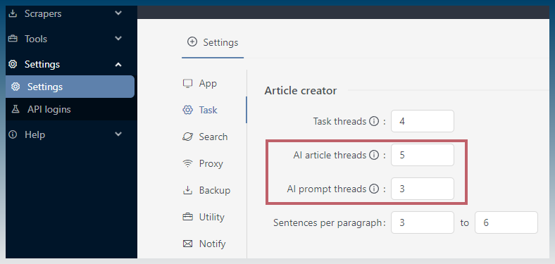

Added 2 new settings to control the speed of AI article generation.
AI article threads = How many AI articles to start simultaneously.
AI prompt threads = How many prompts to start simultaneously.
This requires 2 settings.

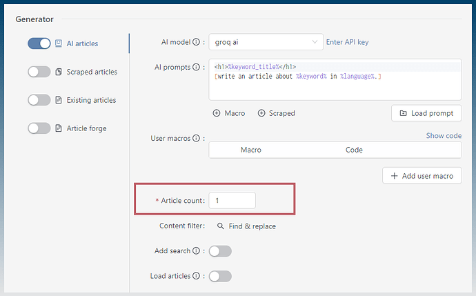

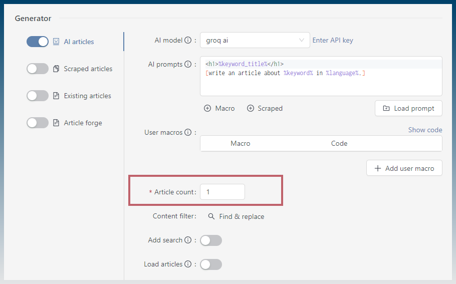

AI article count setting is important for AI article threads.
If you article count is 1, you will never need to multi thread.

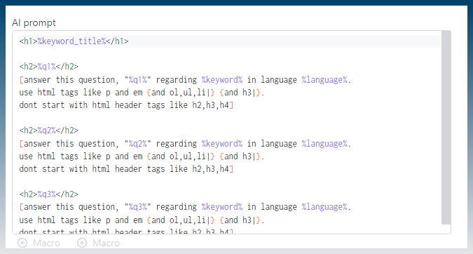

The number of prompts in your AI article template will change how threading works.

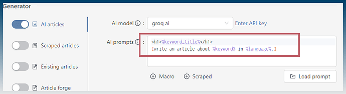

If you only have one prompt, then no threading will be used.
If you are using a template with multiple prompts…
Then the AI prompt thread count can be used to send all those prompt requests simultaneously.
The 2 settings interact with each other by multiplication.
ie.
AI article threads = 5
AI prompt threads =5
Max threads used = 5 x 5 = 25
So 25 requests will be made to your AI model at the same time.
This is good if your AI model supports multiple requests, but other models might start to rate limit you.
Experiment with the 2 settings to find the best set up for you.
