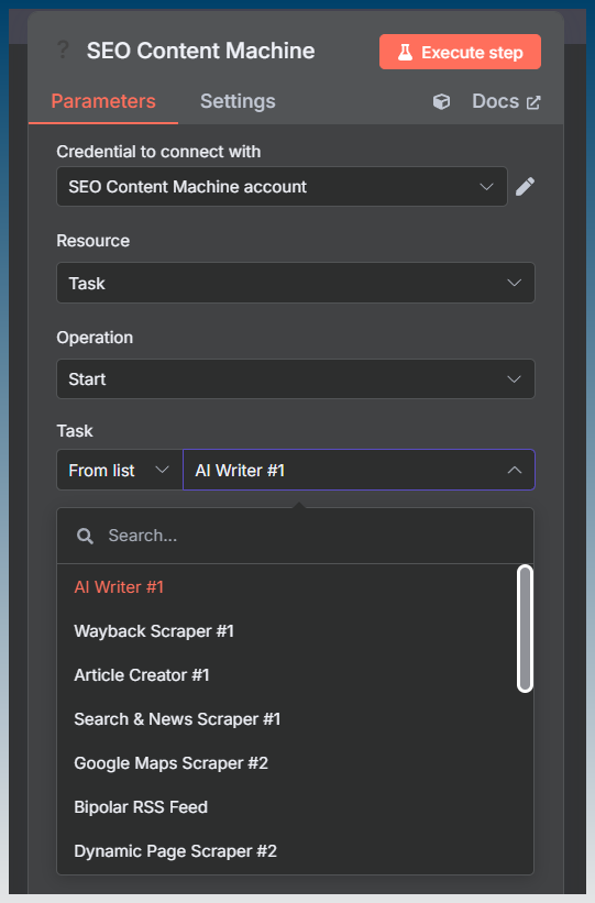

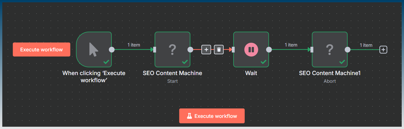

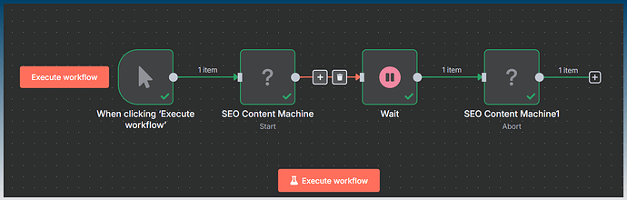

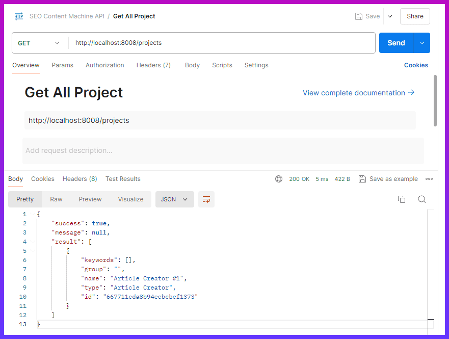

Some teaser screenshots

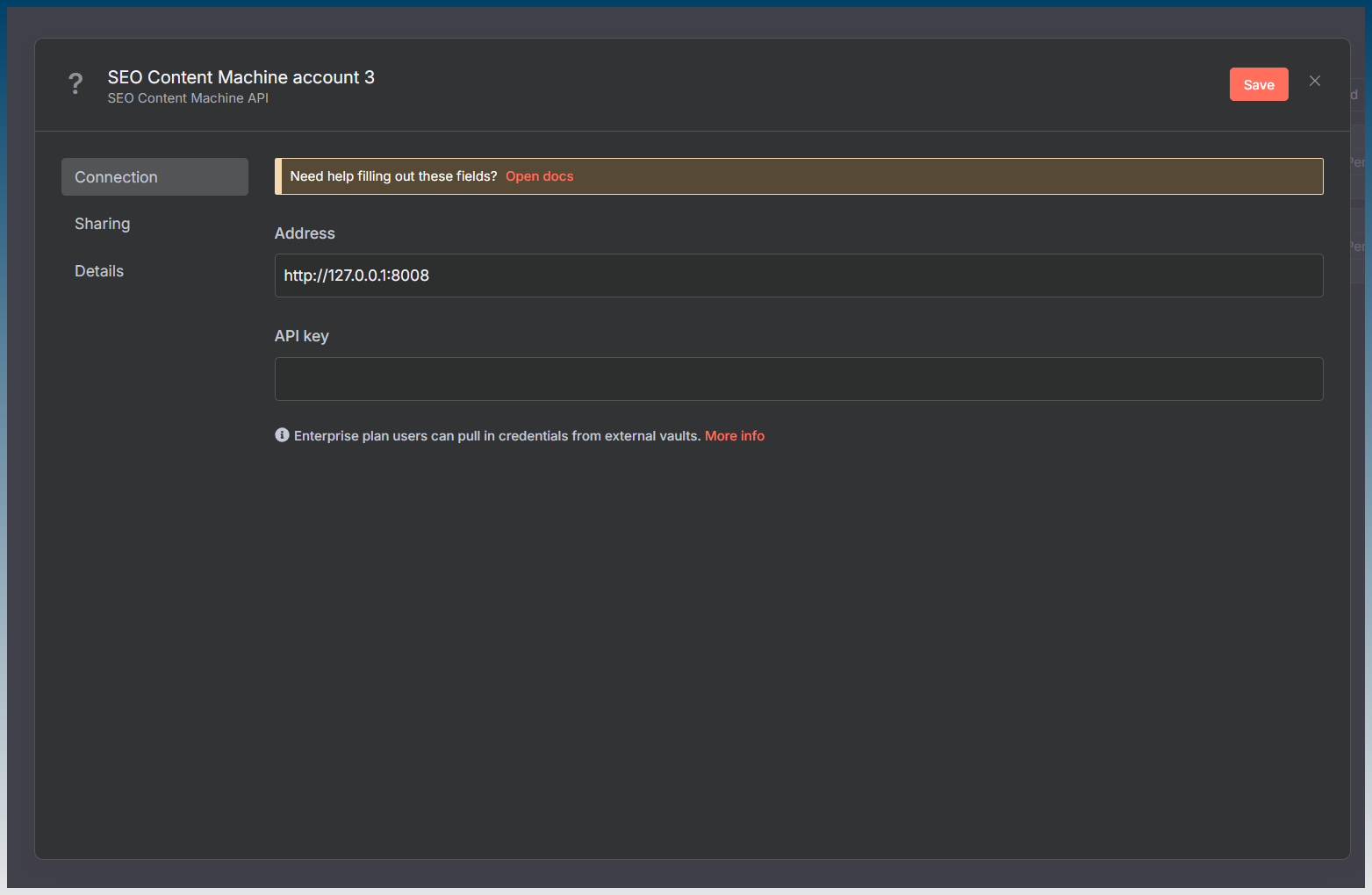

Credentials
Now I’m working on some nodes that will send some basic commands to the SCM API.
The SCM node has been added, and right now it will be able to retrieve a list of your tasks to perform ops on.
All the SCM API routes have been renamed from /project/ to /task/ to make it align more with the n8n nodes.
The newly renamed routes are being added slowly to the node in n8n.
API docs have been updated as well, however you will need the newest version of SCM to access these new routes.
Changes are backwards compatible, so those using older SCM API calls will still keep working.
