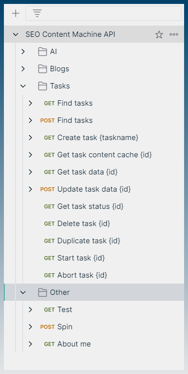

Managed to get n8n nodes to communicate input data to SCM and return that data.
I am also cleaning up SCM API while doing this.
All changes in the SCM API are reflected in the postman collection
All previous API routes are still supported, however only the newest routes are being displayed on postman.
Eg, all project routes renamed to task

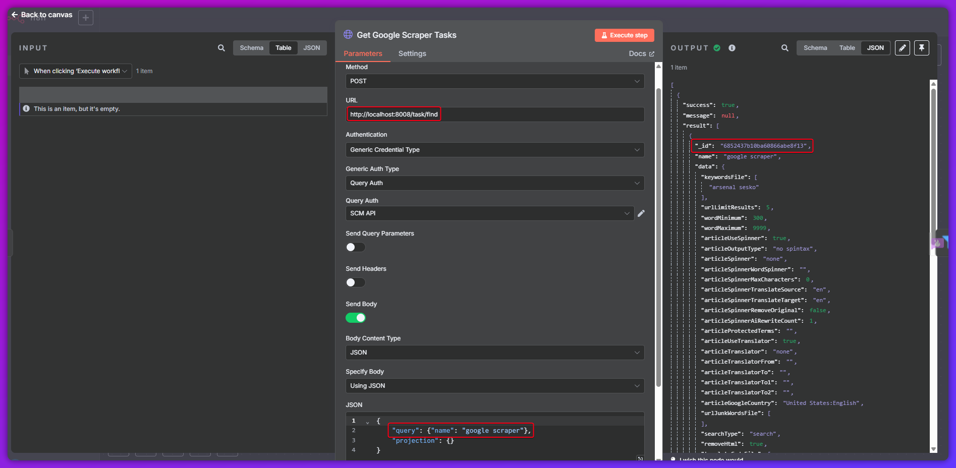

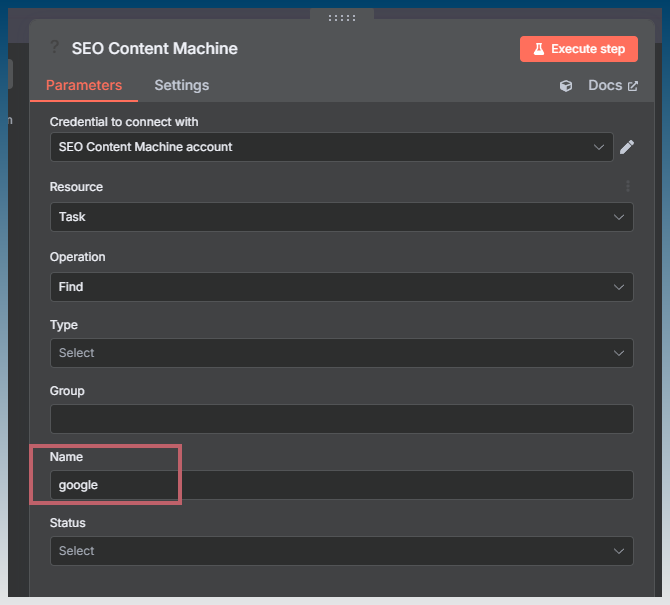

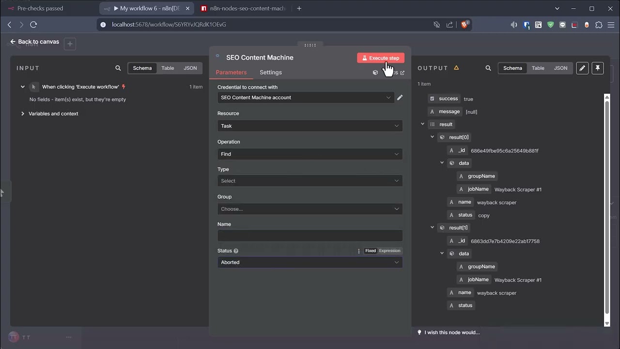

Refactoring the task find inside n8n.
In addition to coding the n8n node, I am also simplifying and redoing API calls where required.

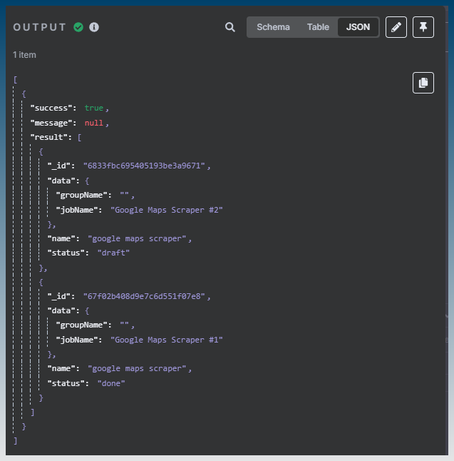

For task name searching, instead of requiring an exact case match to return the task, instead now you can input a partial name.
Do a partial name search for ‘google’
FYI: Task name is jobName in the database.
Just tasks with Google in the name.

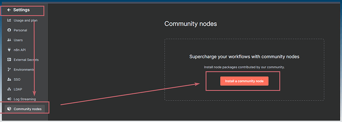

I have officially published the SCM n8n node on on the npm registry
https://www.npmjs.com/package/n8n-nodes-seo-content-machine
For now calls are limited to start stop, get data.
No task data editing yet, while I figure out best way to add it.
However it means you can install and try it out on n8n.

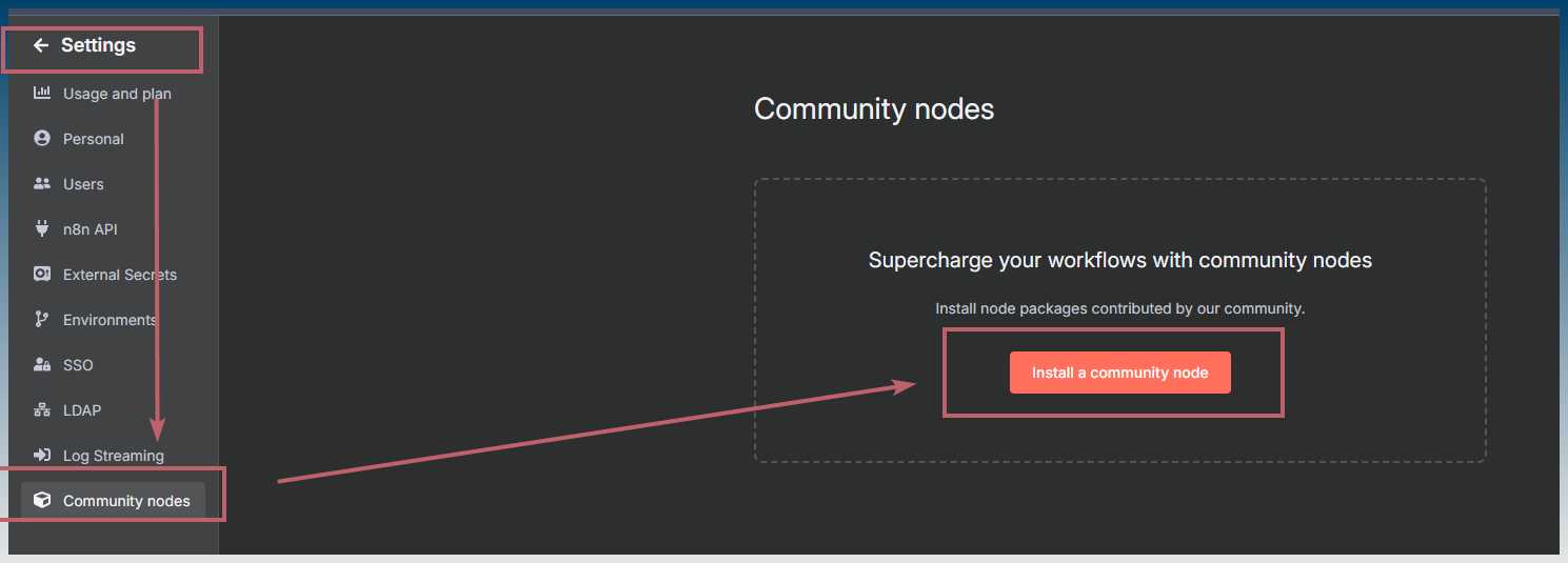

How to install it
Go to install a community node
Package name
Install it!
Integration is pretty barebones until task editing is added, so please report bugs and provide feedback.
I am early publishing this so that at least you can get your hands on what is working.

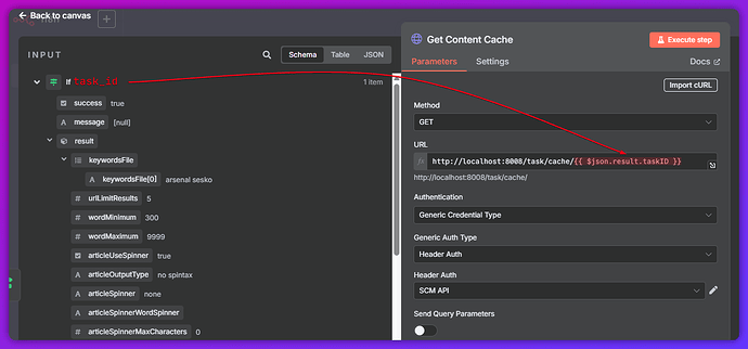

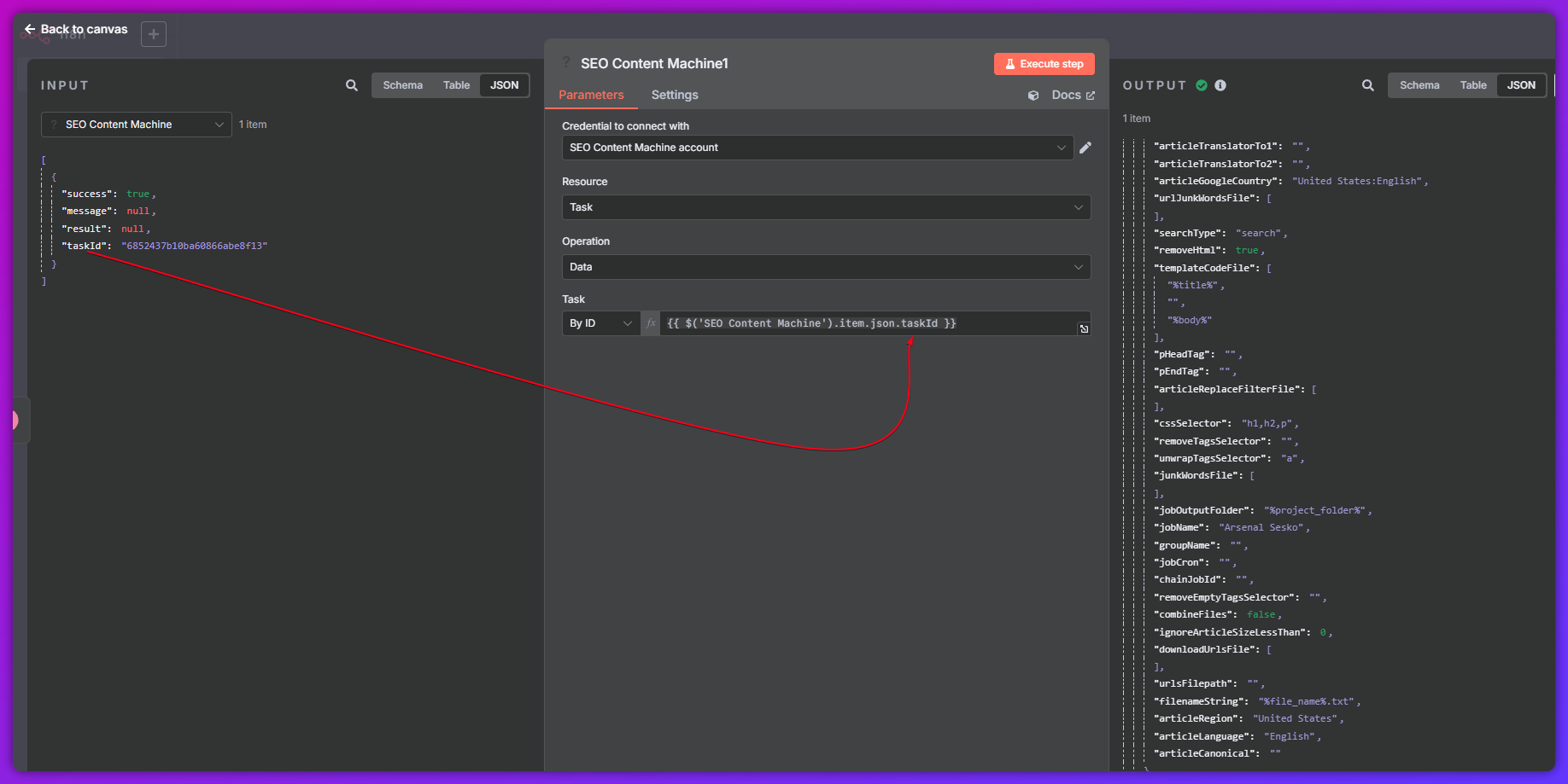

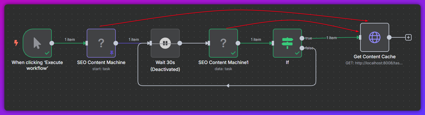

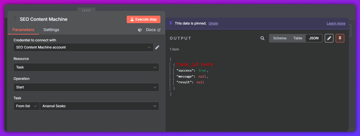

The most crucial is task id. Can you add to the json for each node?
So I can use custom api call and pass the {id} value. It’s just for convenience.
Currently to get task id is to add task/find node
bukit
June 18, 2025, 5:54am
29

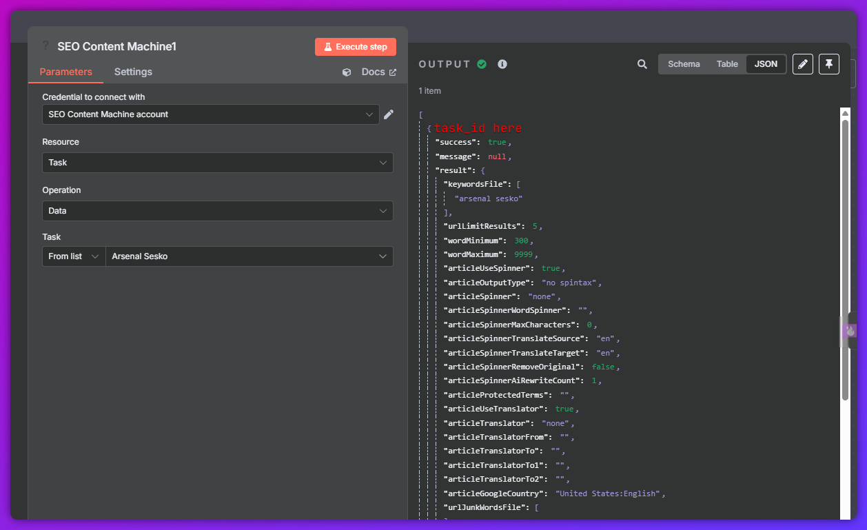

bukit:
btw Operation Data doesn’t have status ‘done’.
Does success true = status done in this node context?

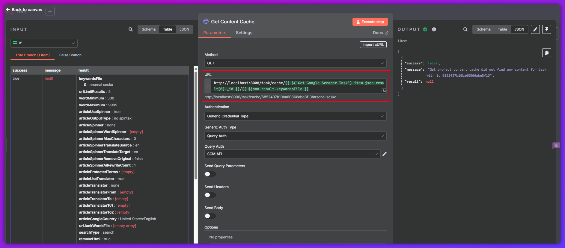

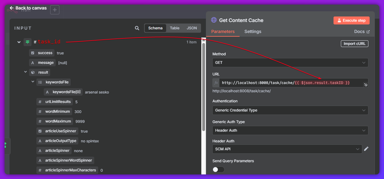

Get task cache for all task not just article creator task
Tim
June 18, 2025, 7:35am
31
Yup, let me make sure all api calls return task Id so it’s easier to chain.

32
Data just returns the actual task data. You use it as is to update the task properties.
Things like task status, does not belong inside the task data.
It sits outside the task data struct, like task create time.
There is a separate call to get task status.
Task status is read only, while everything else in task data is considered amenable to changes by the user.
Result success just means the api call passed, it is not the same as the task status.

taskid added as return for start and abort.
Investigating task cache call now.
Tim
June 18, 2025, 10:00am
34
Just released new update for scm with taskid added to return calls.
Let me know any calls that are missing this.
For content cache, it is only for the article creator as it returns the cached titles sentence paragraph etc content inside cache.
Looks like you want to get result of a task output, so I have to add a new api call that will return the result of task output folder.
Will be most likely an array with file name and file content.
Not sure about security implications of allowing this though.
It does mean you can create a task and set output folder to any arbitrary folder on your hard drive and get a file listing with file contents returned over the api.
Might have to also cap max file size readable as you prly don’t want to send 1gb file via api too.

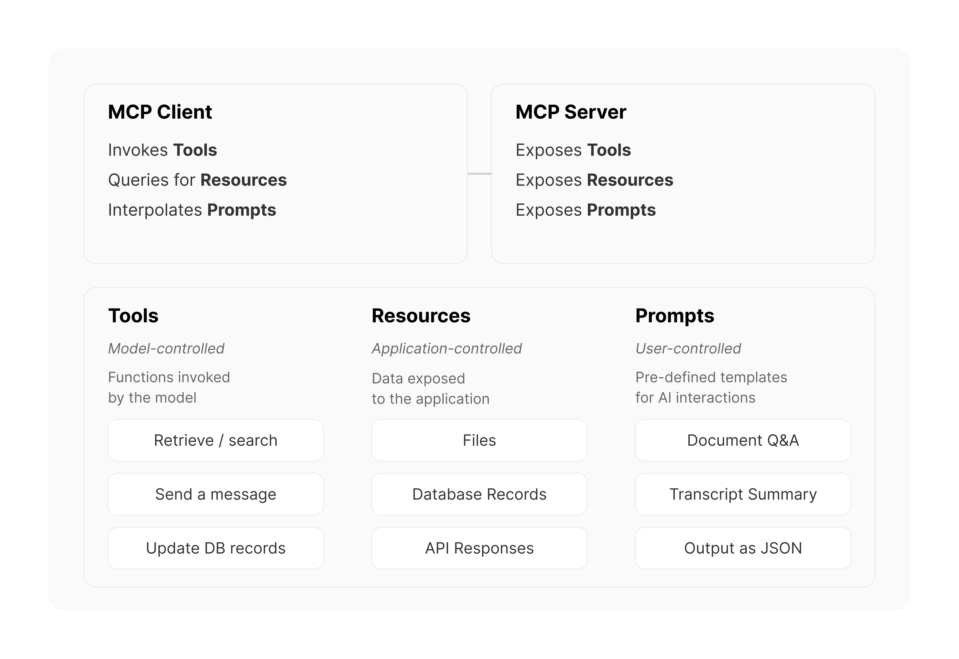

This is actually similar with my future request, not for data json only, but the curl command with included json data so i can import to n8n http request node. This is for human, a workflow node, not agent tool.
I think for human, just keep it simple like normal multi step api call, we can share n8n workflow.json as a quick scaffolding task creation or create an mcp server template (contain all scm api endpoints , read only documentation and AI prompts).
MCP is just a standardized way to organize tools, resources and prompts.
I believe n8n is the easiest way to create your own controlled, secured mcp server without coding.
Here are some example mcp server templates (as you can see, the pattern is clear)
If you have several website, you don’t create another mcp server per site, build the server once, call within any new workflow.
One great thing about MCP is that it’s client agnostic, you can use whatever client app that can call the server.
In this example, change the chat trigger node to discord/telegram/whatsapp message trigger as your ‘mcp client’

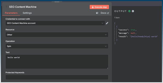

Added task update to n8n node.
npm package has been updated as well.

SCM n8n node is now feature complete.
I am going to start submission to have it listed as an official community node
