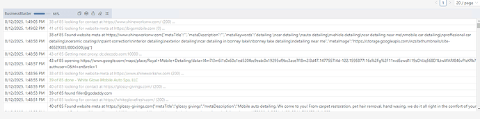

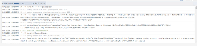

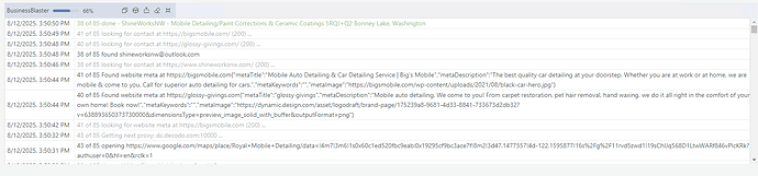

For some reason … Google Maps Scraper freezes on every single time when it gets to a certain listing or set of listings. I think it might be something in the listing’s website that hangs up SCM. I’m not sure which website it is but maybe you can tell from the freeze screenshots. I had to force-close SCM and reboot to restart scraping.
Freeze 1
Freeze 2
Freeze 3
I hope it can give you some hint as to why SCM freezes. I am going to try skipping the keyword for now. if it happens again .. i will update you.

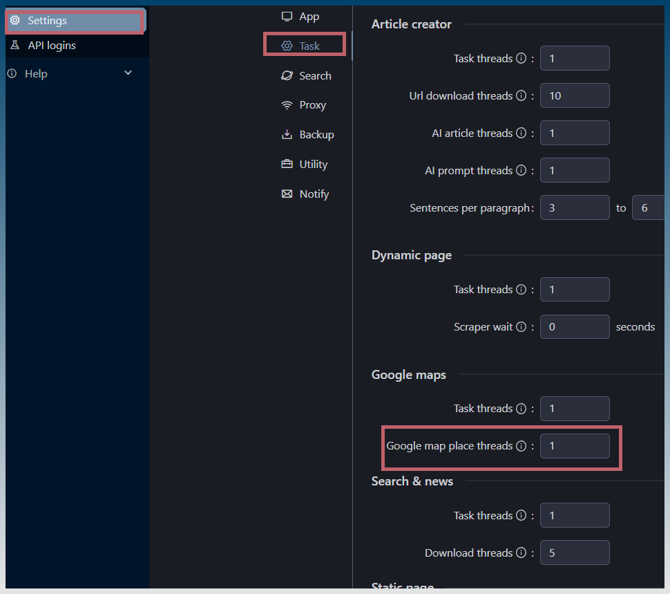

Set google map threads to 1
Then run the task again.

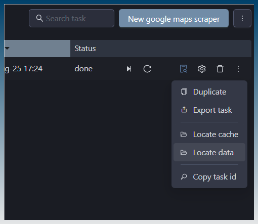

Or export the task and send it to me.

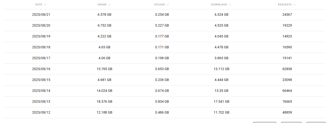

Take a look at my proxy provider logs:
You’ll notice I went from 70,000 requests per day to around 20,000 per day scraping Gmaps .. almost overnight. Not sure if it’s SCM or not. Was anything updated in SCM last week that might have effected gmaps speed?
I added proxy support to the scraping of websites, not sure if you are using the new proxy options?
This slowdown happened overnight .. but I think it was before you added the 2nd proxy box. according to the dates in my proxy provider log .. the slowdown started around Aug 17 .. compare to your release changelog. I remember there was a different update LAST week .. I’m not sure what actually changed on that update .. but I think that’s when the slowdown started happening.

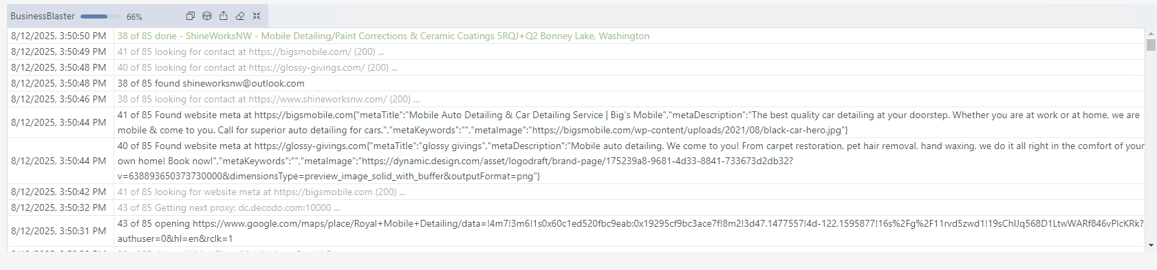

When I watch it the speed doesn’t seem much different … but looking in log .. i notice 8min - 10min gaps between entries that I haven’t seen before .. (which I would think would be highly unlikely with my threads set at 5 map /10 task )
8/23/2025, 4:55:46 PM	26 of 41 opening https://www.google.com/maps/place/Affordable+Mattress+Inc/data=!4m7!3m6!1s0x52b32df296d131c1:0xb3fef3443d4c0c4c!8m2!3d45.0046858!4d-93.3079924!16s%2Fg%2F1td587th!19sChIJwTHRlvIts1IRTAxMPUTz_rM?authuser=0&hl=en&rclk=1

Very big 8min gaps.
Can you set threads to 1,then run it again.
I need to know at what steps it is getting stuck on.
Paste in log again once you run it.

How many other tasks are you running simultaneously in SCM?
I looked closely and there is a 1sec delay when posting log messages from google maps browser.
Not sure if it makes any difference, but I removed that delay.
How skip code works is that it loops an array and prints out any urls that already exist in that array.
Unless that array is massive, I don’t see why it would be so slow.
Can you open the task data folder.
Look for the partial plusurls file
How big is that file in the task you are running?
only 1 task at a time. I pick 1 town and scrape 200 business categories in the town. Usually It works out well, because there are alot of overlap duplicates from Google between the categories and SCM auto-removes the duplicates.
The plusurls file is current 1.6MB … what does this file do?
What was strange was just how it slowed down overnight .. going from 70k requests per day to 20k requests per day literally the next day. This didn’t matter when I changed tasks.
Can you export that task and also send me the plusurl file?
I will check if that is causing the slowdown or not
Did you try the new SCM update too?
