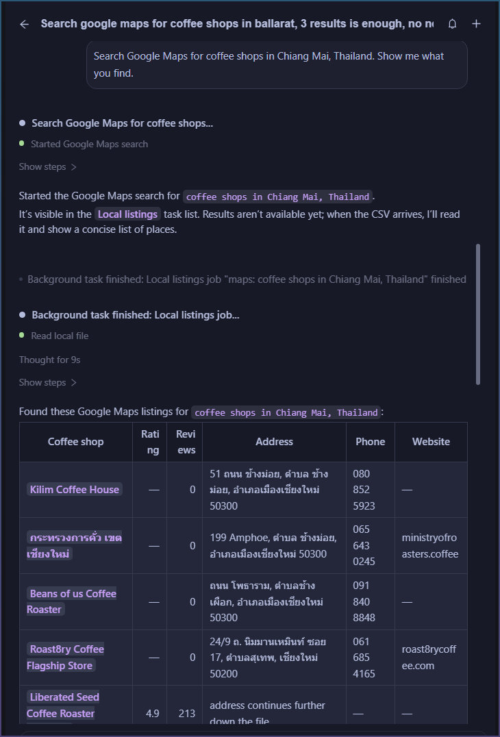

I think MCP would be very interesting for those who use Google Maps to scrape contacts. Imagine asking Claude to look up an address or even asking him “give me 20 barbershops in London,” Claude will simply scrape and get that answer in real time. I think that would be a huge differentiator.
Yes that is perfect first step demonstration of MCP and agent skills.
Its easy task to call, relatively little parameters.
The agent BETA update is already in closed BETA, and as long as no big problems, Ill invite everyone to try it out in a week.
I’m hoping that the open BETA will include the start of MCP with at least Google maps on there so we can POC the concept.
