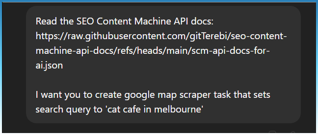

Instead we give it the JSON API docs
https://raw.githubusercontent.com/gitTerebi/seo-content-machine-api-docs/refs/heads/main/scm-api-docs-for-ai.json

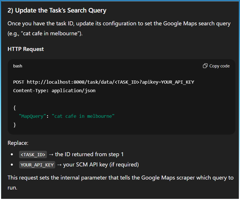

Here is query.

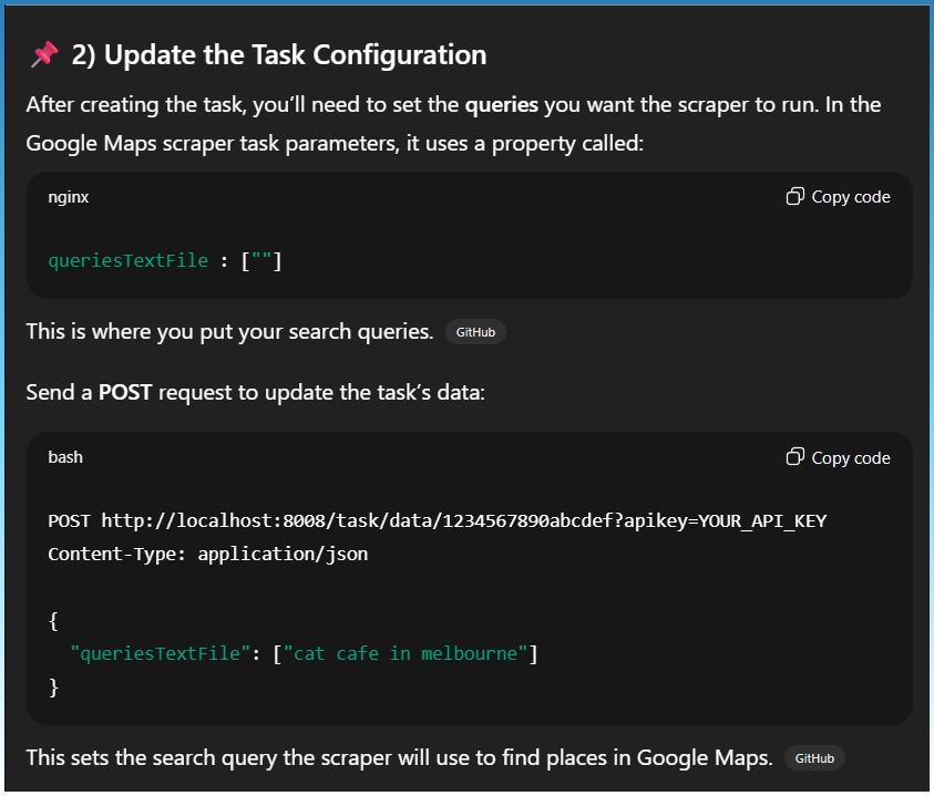

Unfortunately it gives bad advice here
There is no MapQuery.

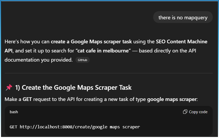

So I told it in chat.
Now it seems to re-read the JSON api docs properly.
This advice is correct.

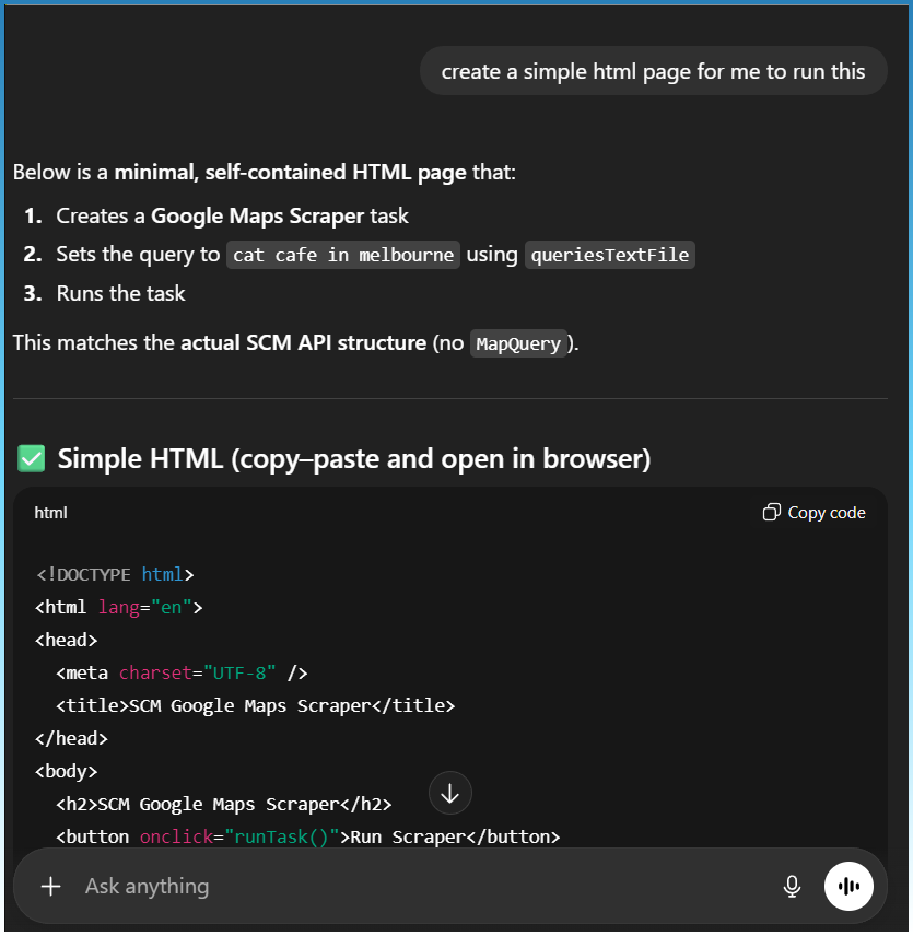

We can tell it to create a simple html script to check if it works.

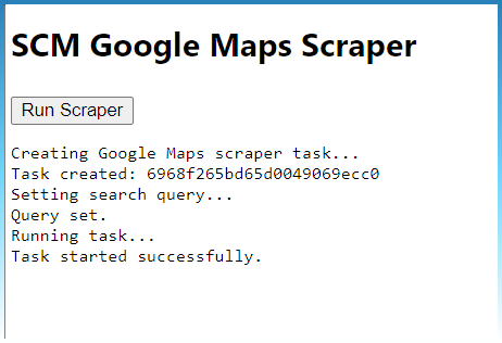

Running the html file.

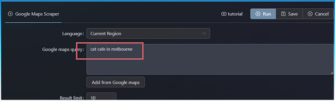

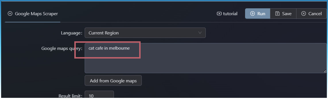

Verifying it worked in SCM.

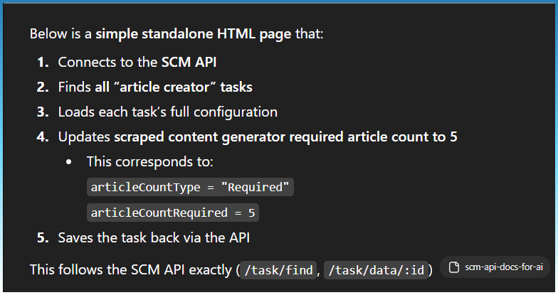

eg: Bulk editing all Article Creator tasks to generate 5 scraped articles.

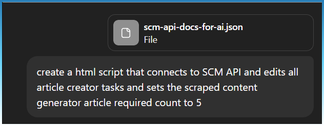

Instead of telling it the JSON API url, we can download the file github and attach it as well.
As long as the prompt is accurate and specific it tends to understand.
If you have problems you will likely need to run the output check whats wrong and tell ChatGPT what it needs to fix.
However with the JSON API file, it is much more accurate than if you tried prompting it without that file.
