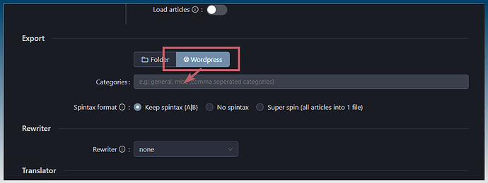

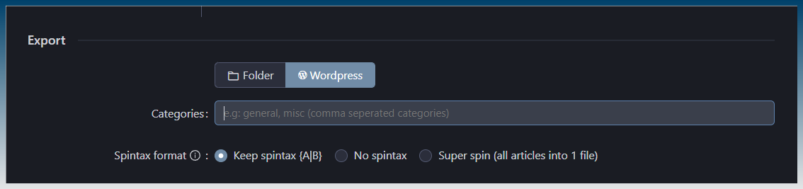

When using the article creator, the Wordpress export option only allows hardcoded categories.

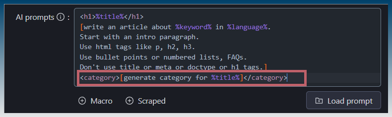

If you want to use AI generated categories you need to use the <category> tag method.
Add a category tag to your AI prompt
You need to add <category> tag to your prompt.
You can decide the best way to generate the category.
In the example above I ask the AI to generate one using the article title.

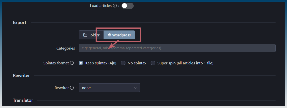

You can still use the Wordpress export option, just leave the category box blank.

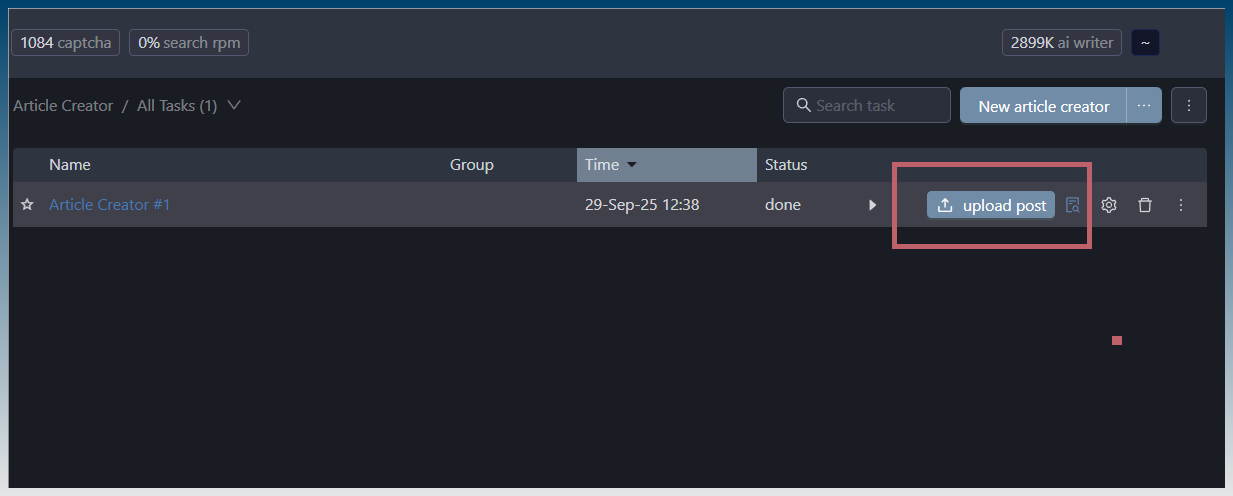

Once the task is run click upload button as usual.

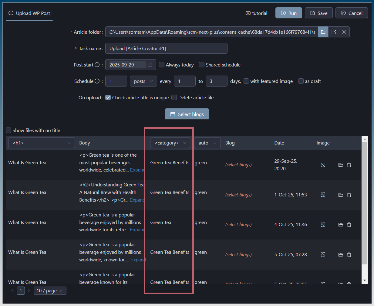

The posts are tagged with the right category, as generated by the AI.

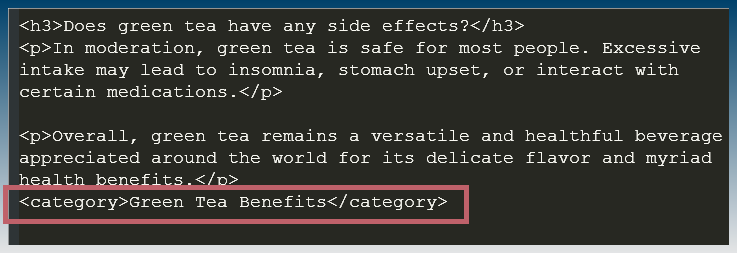

How does SCM detect the category in posts?
The output of the article has tag in it.
SCM uses this tag to set the category of the post.

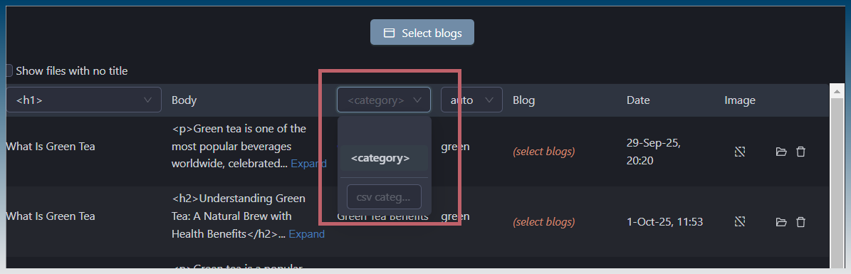

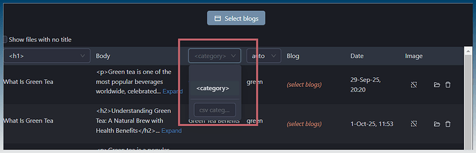

If you click on the category drop down you can see the option in the list.
The category tag is removed from the article body before being posted online.
