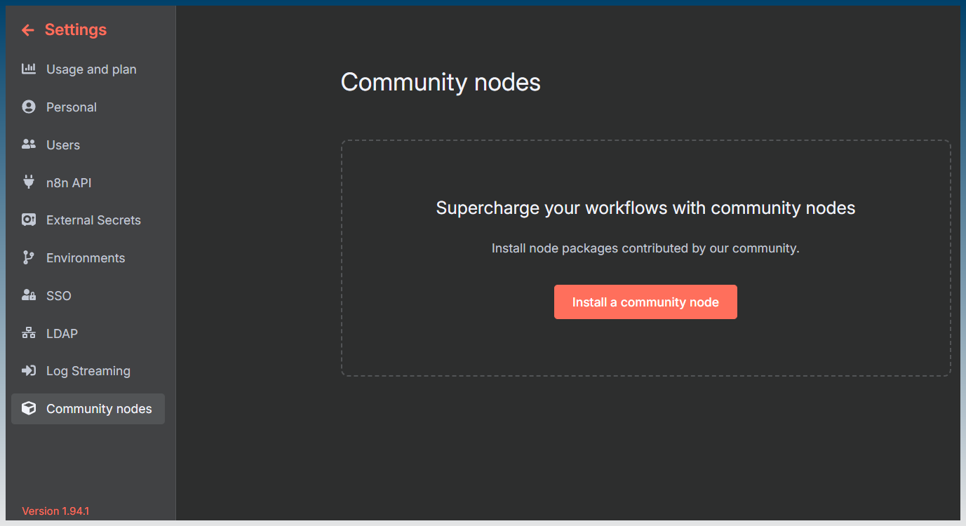

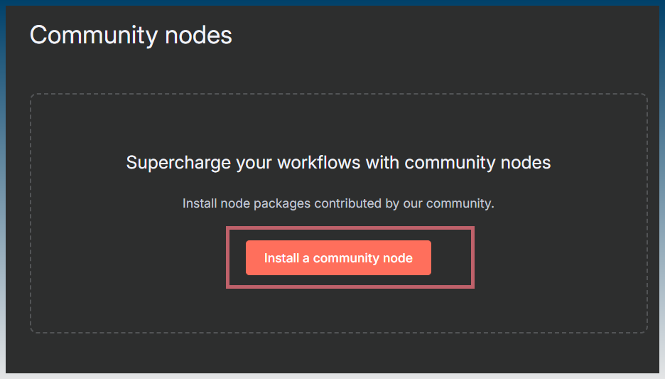

Assuming you have it installed and ready, here is how you can install and setup the SCM n8n node.

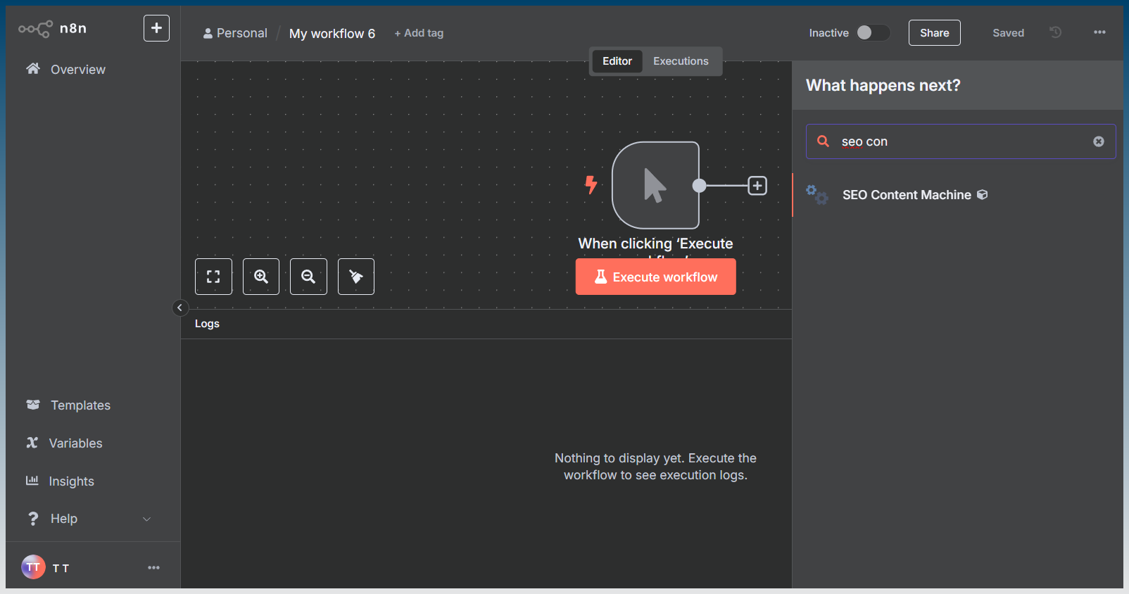

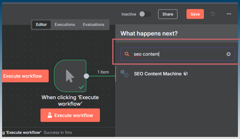

You can find the SEO Content Machine node in the list!

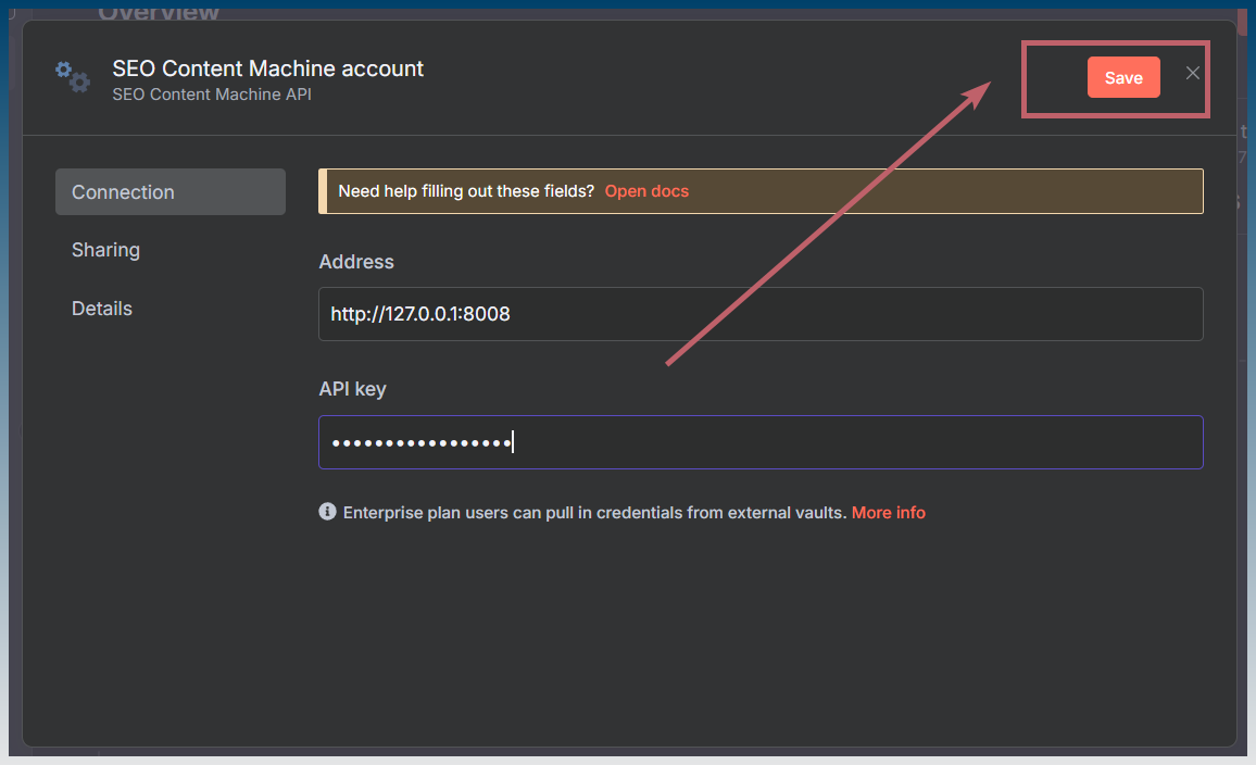

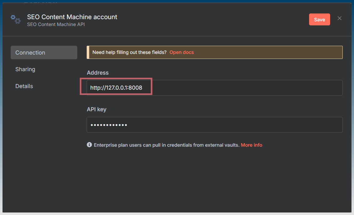

Add SCM credentials

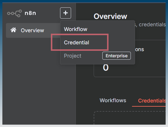

Before you can send requests to SCM you need to add a credential.

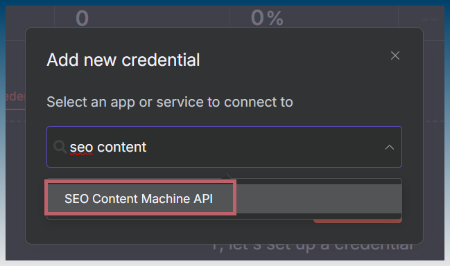

In the corner menu > credential

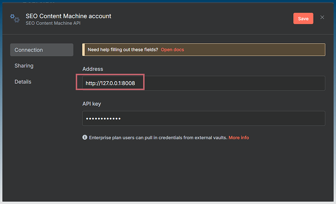

Find the SEO Content Machine option

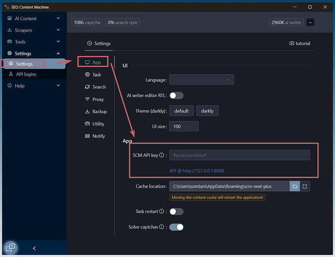

The connection is pre-filled with defaults

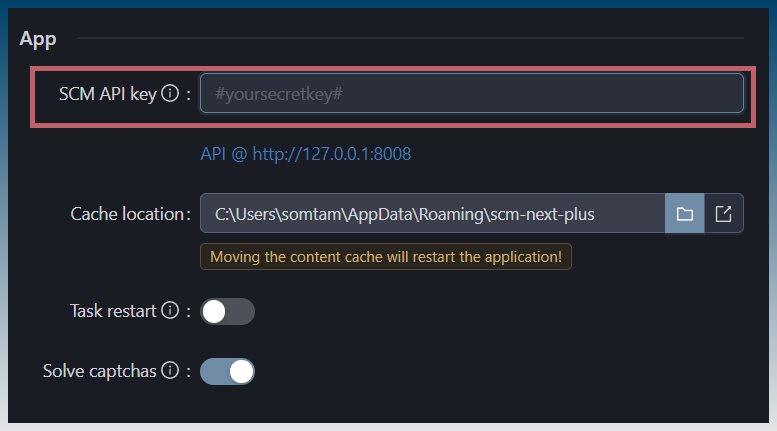

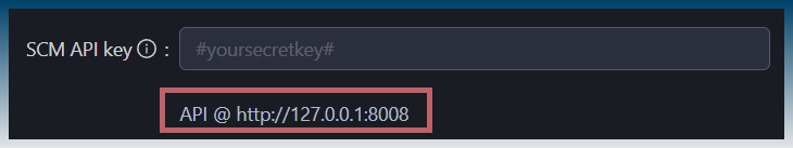

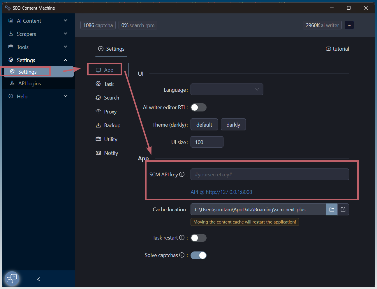

Open SCM to verify
The address is listed here:
Default is
http://127.0.0.1:8008/
Which should be the same as n8n.
If you want to access SCM outside your network, you need to look into port fowarding.

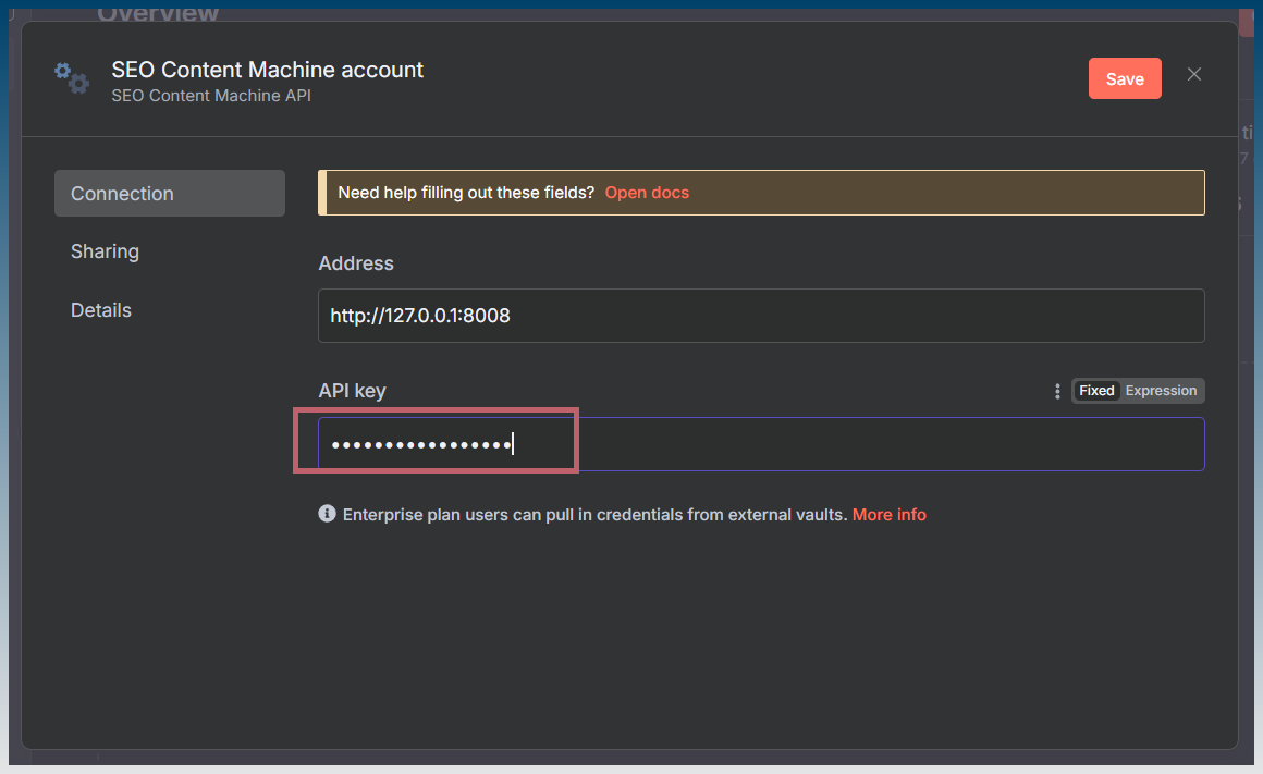

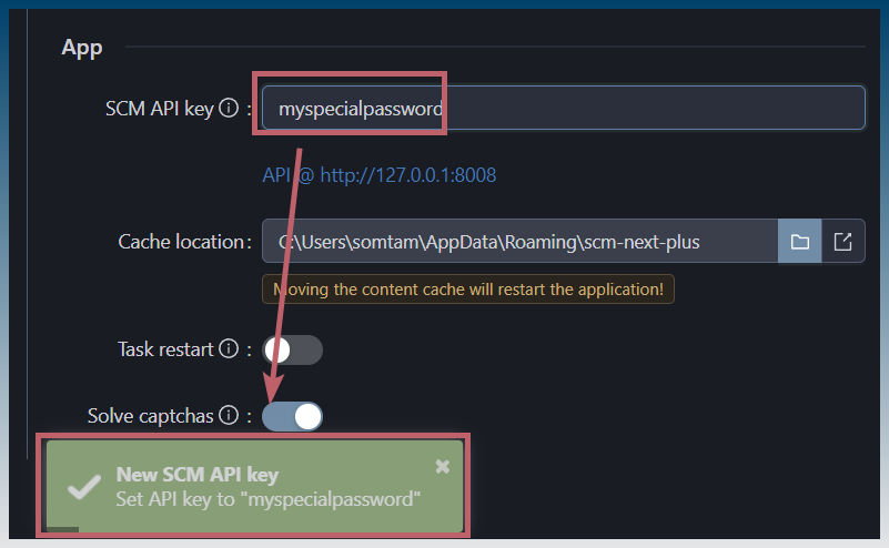

You should add a password to the API key field to protect access to SCM resources.
A password is recommended if you are going to port forward SCM to public internet access.
Add a password in the SCM API key field.
eg
Now all requests are secured.

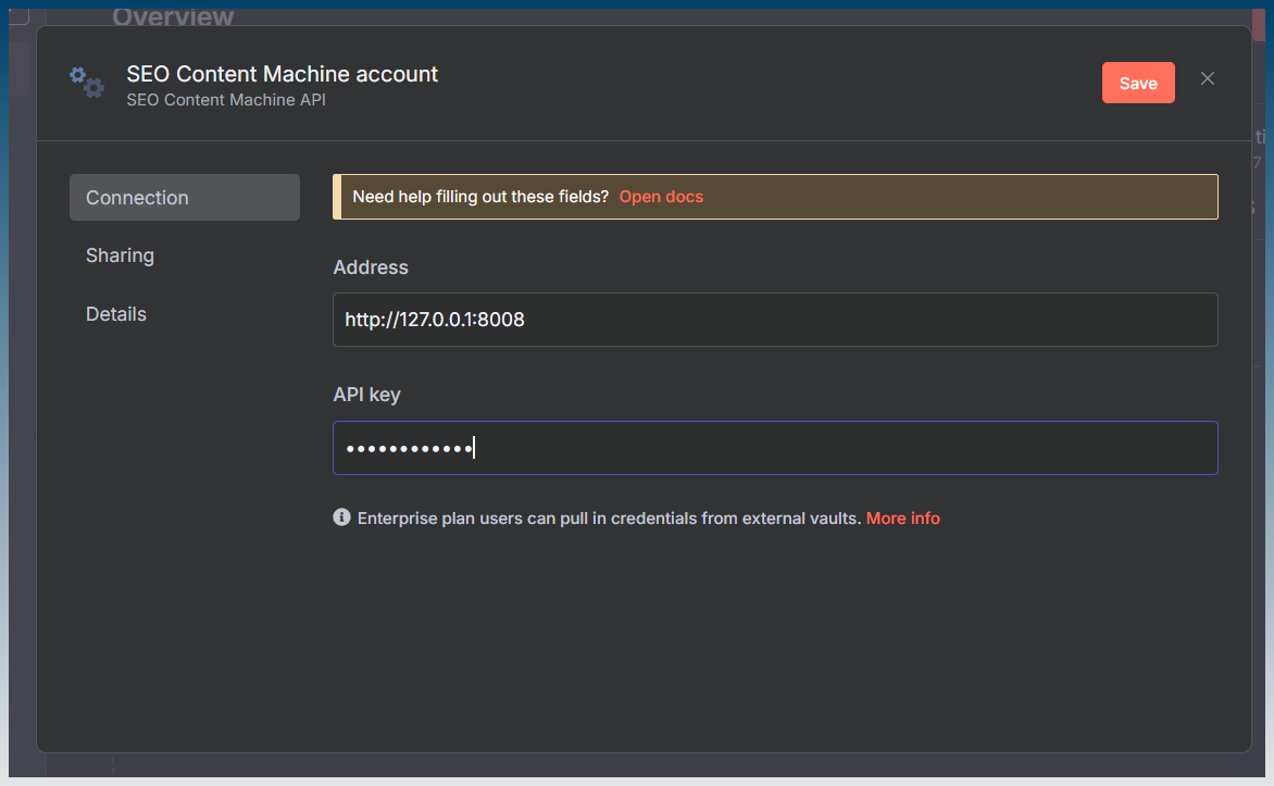

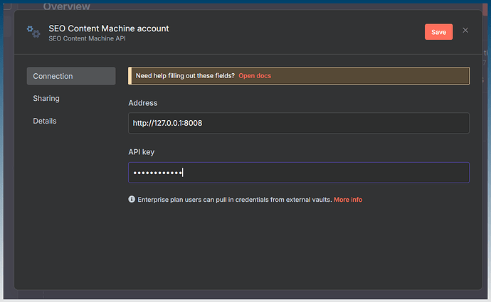

This password should be also pasted into the SCM n8n node API key field.
Save the credential

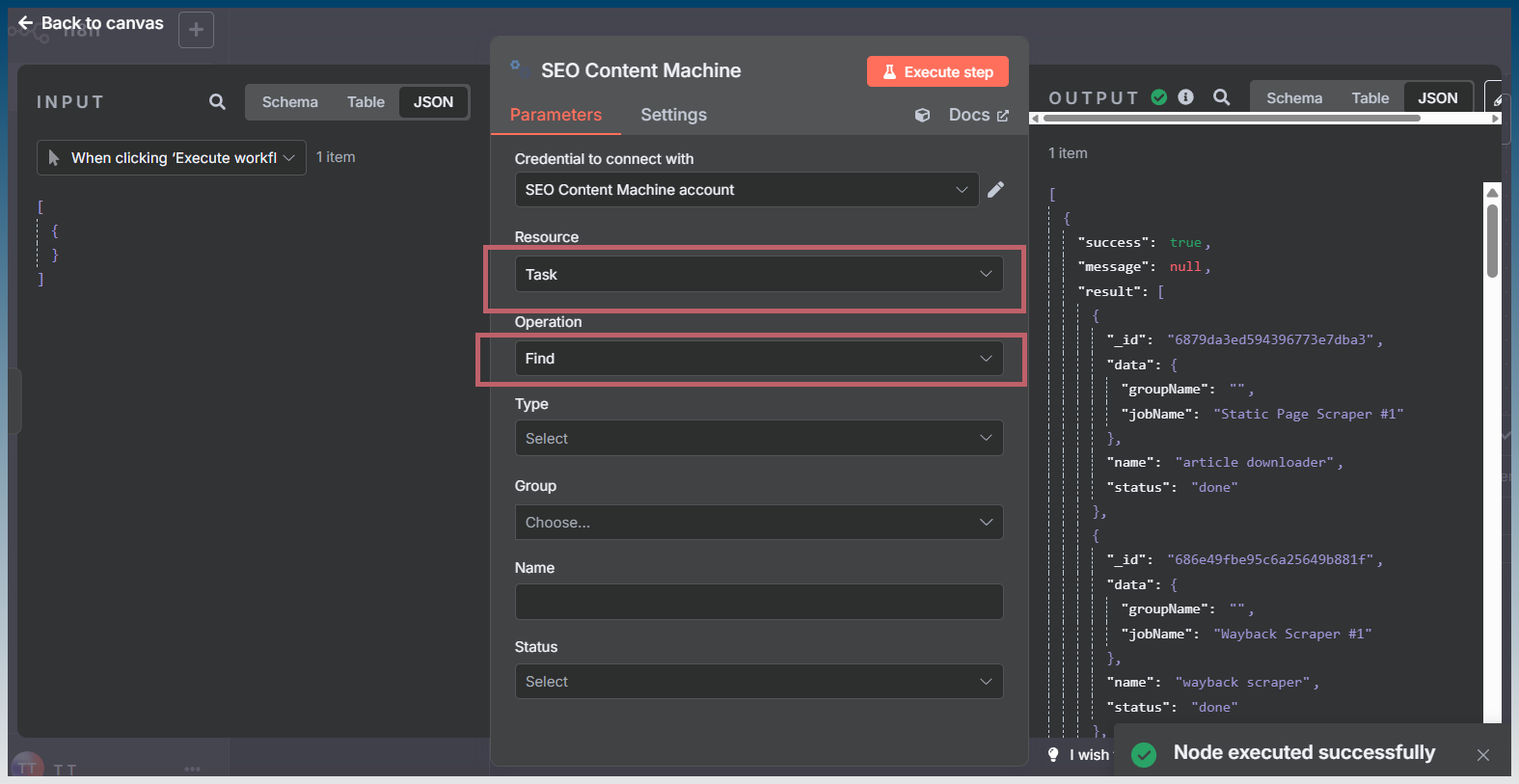

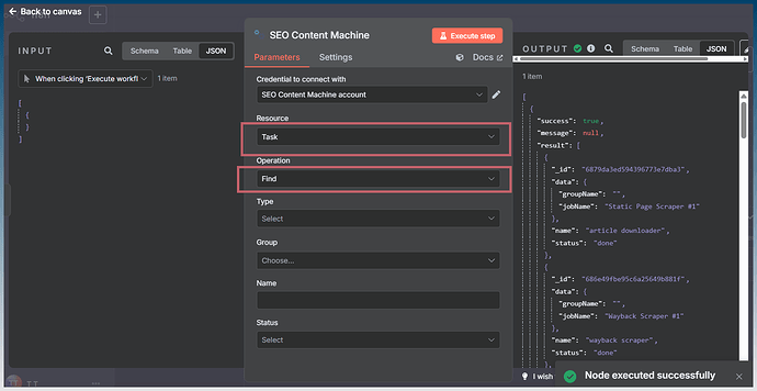

Test SCM node
You can test the SCM n8n node by adding it to your workflow.
eg: Run a simple task find operation
