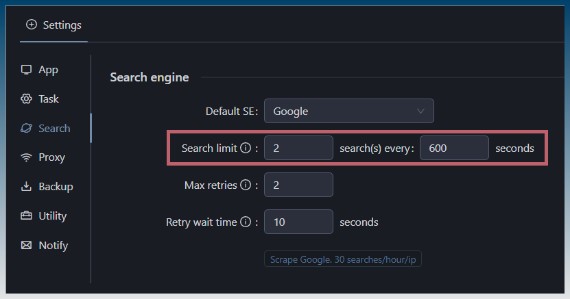

Limit searches to xx in 1 minute, remove the existing delay based option and instead let SCM slow down each request so its only xx per minute
Added search limit, which now replaces the delay time.

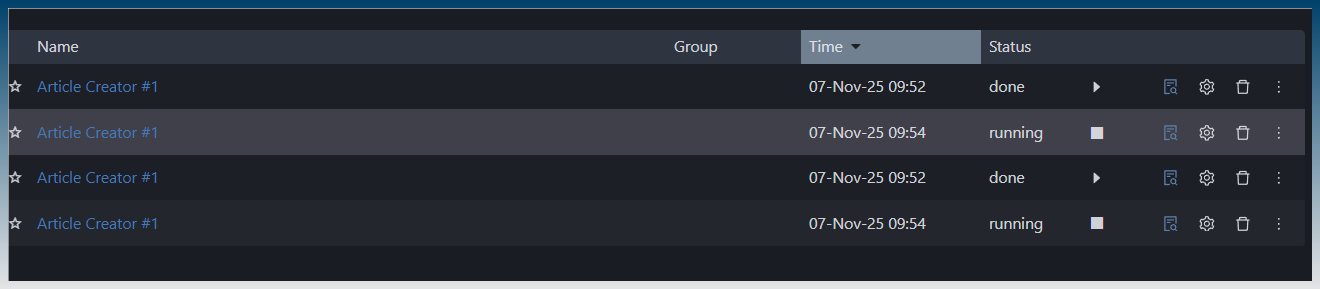

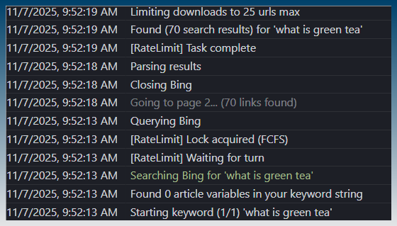

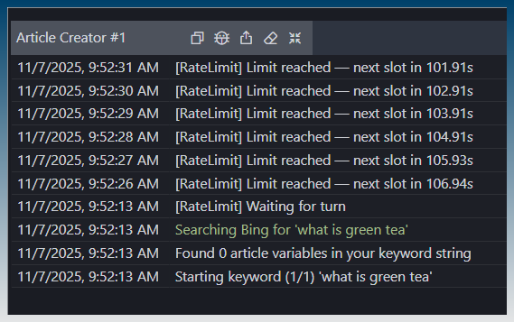

Rate limiter working.
Each task will wait for its turn to access the search engine.
If there is a free slot it proceeds.
If there isn’t a free slot it will wait.
With multiple queued tasks, each one will wait as required.
Only one active search engine window can be opened at the same time.
So SCM will never open 2 windows to Google at the same time.
Even if you allow 3 requests in 60 seconds, each request has to be completed one at a time to avoid looking like a bot.
