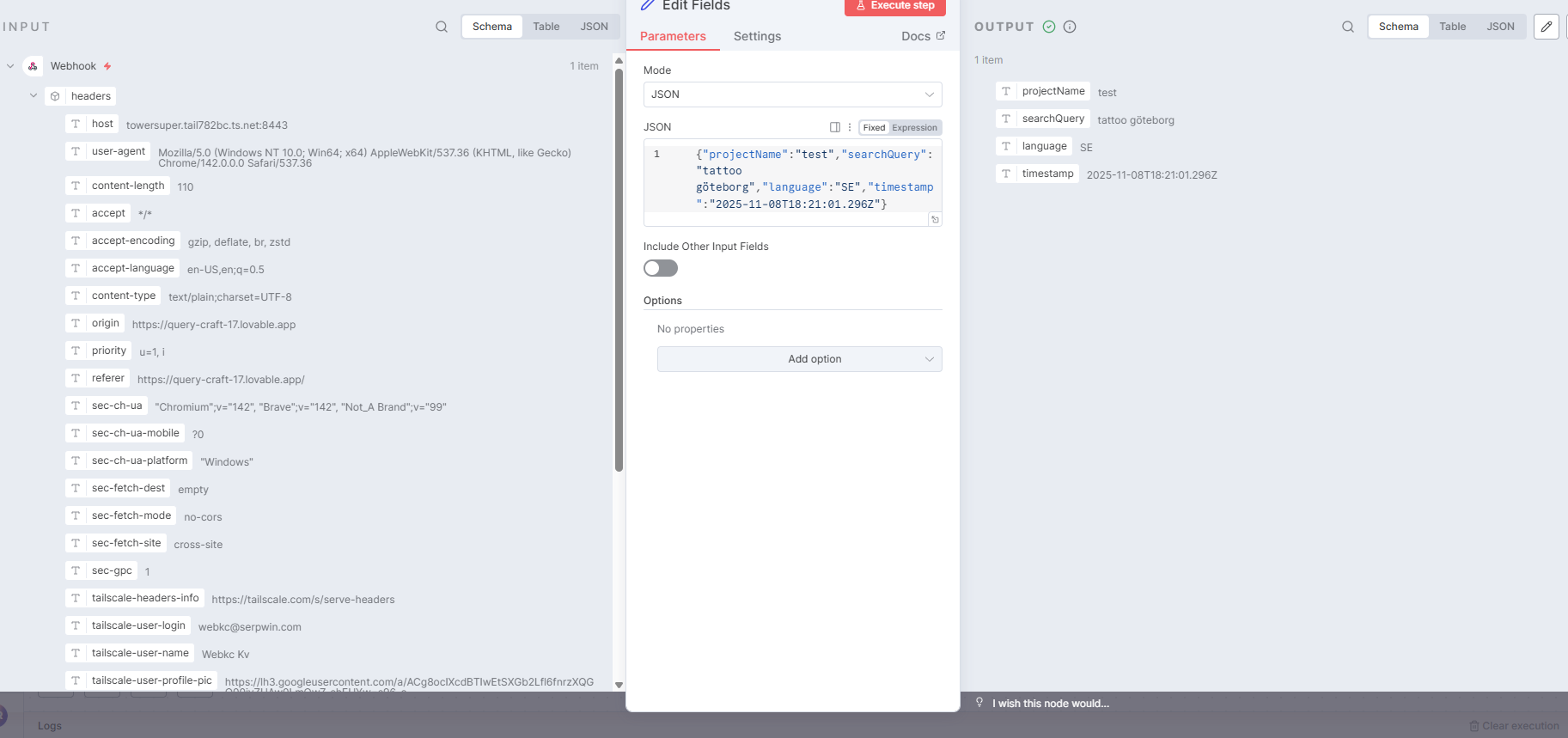

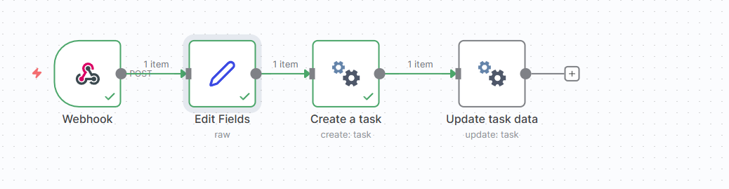

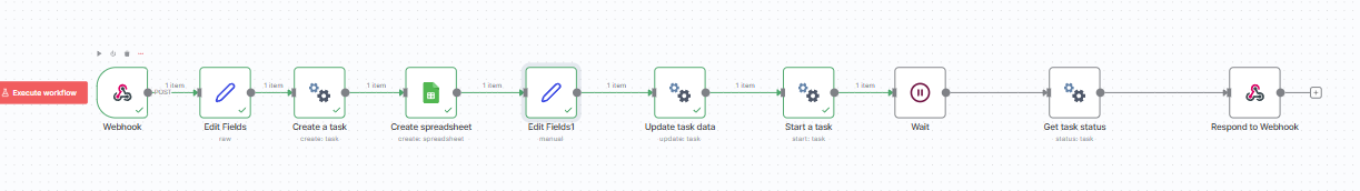

hi i would like to use a form send to n8n and a google maps scraper job. the webhook works
i can create a google maps scraper project. the logical step i thought was to update the task
but i have no clue on how to do it
there is no visable option where to put search query

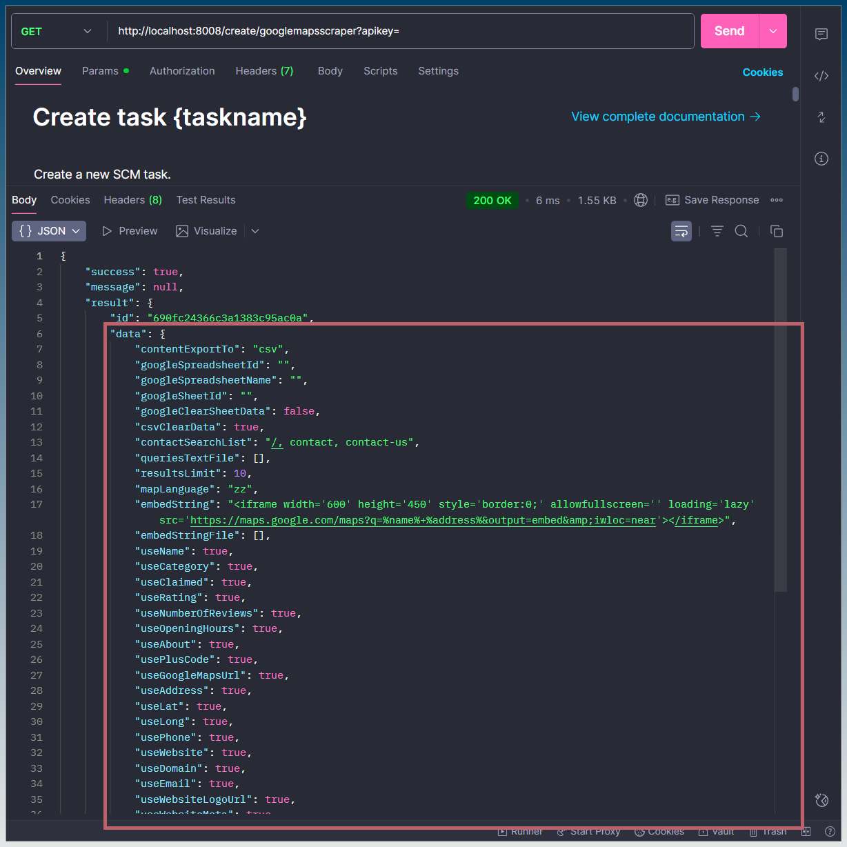

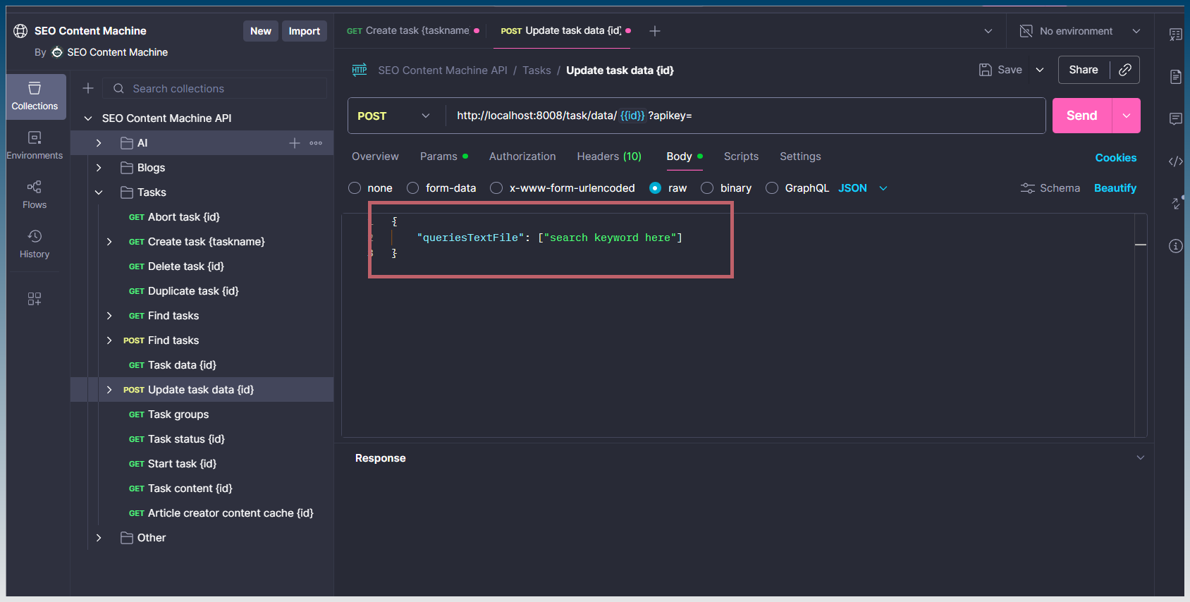

After you create the task you get given a data object. Like this:

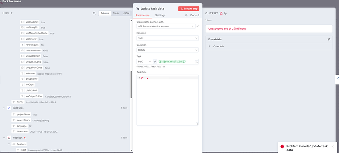

To do the update you need to edit this object and pass it back to the update.

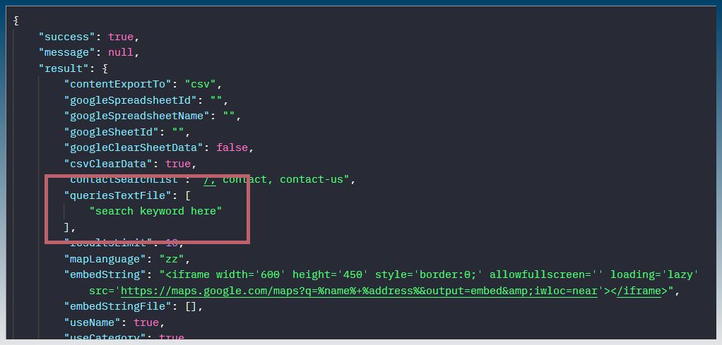

You can pass back only the items you want to change
You are using n8n but its the same idea.
Task ID you have already but the text box just paste in this, (or whatever you need to change)
    "queriesTextFile": ["search keyword here"]
It works when you see this:

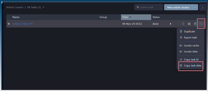

To make it easier, you can also copy task data directly in SCM window now.
