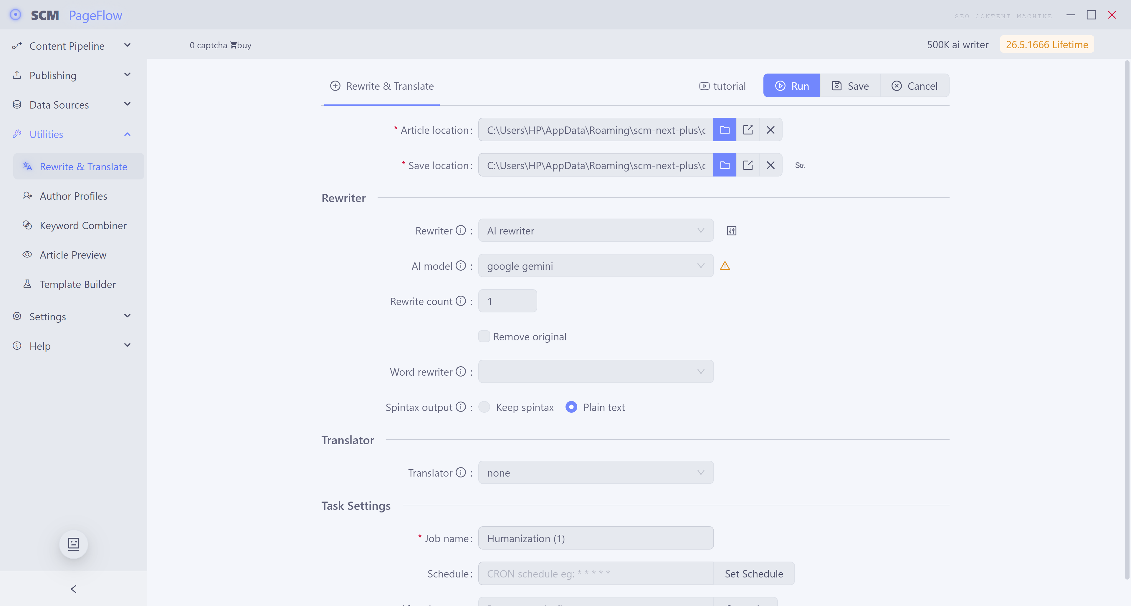

AI rewriter, send as 1 article not split into lines
Yes, I have updated, now Page Pipeline is taking local articles as reference.
As for AI Rewrite, it is still sending requests by paragraphs. Is it possible for you to add option of Full Article or Paragraph wise requests?
If you can add option of prompt changing like Page Pipeline in AI Rewriter (instead of settings), or Add option to process Each file as single reference or All files as single reference option in Page Pipeline builder.

I am talking about AI Re-writer & Translator, it is sending rewriting requests by paragraphs, which is overloading API requests and rewriting is not that much successful. Suppose, I send request using prompt, if whole article is sent, output is usually under 20% AI score in zerogpt with Gemini 2.5 pro model, but if I send paragraph wise requests, it won’t be able to humanize or properly remove AI patterns from whole article. Sending whole article for rewriting not only save API requests, but also properly rewrite the whole article as per requirements.

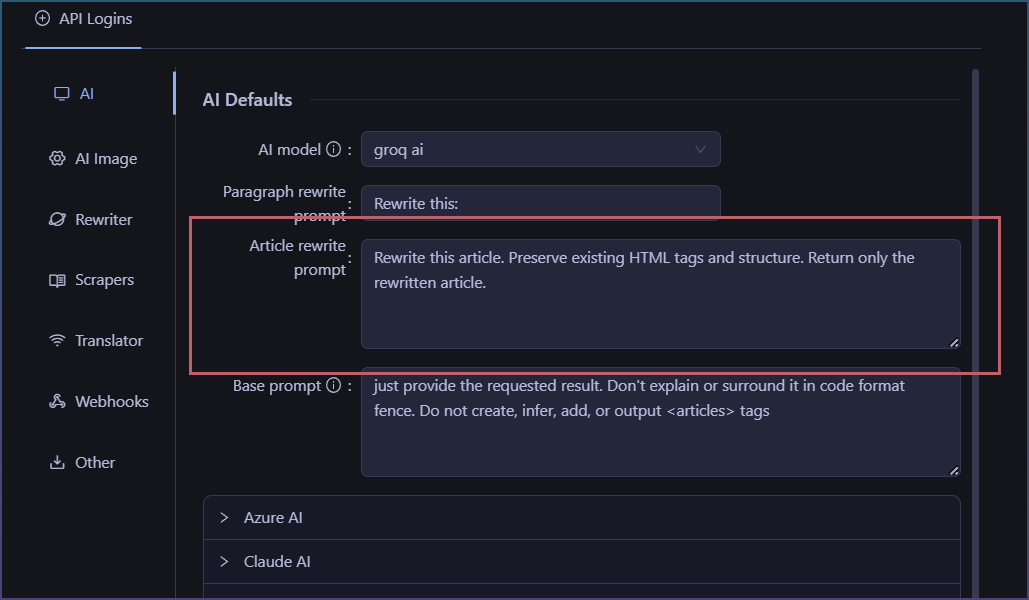

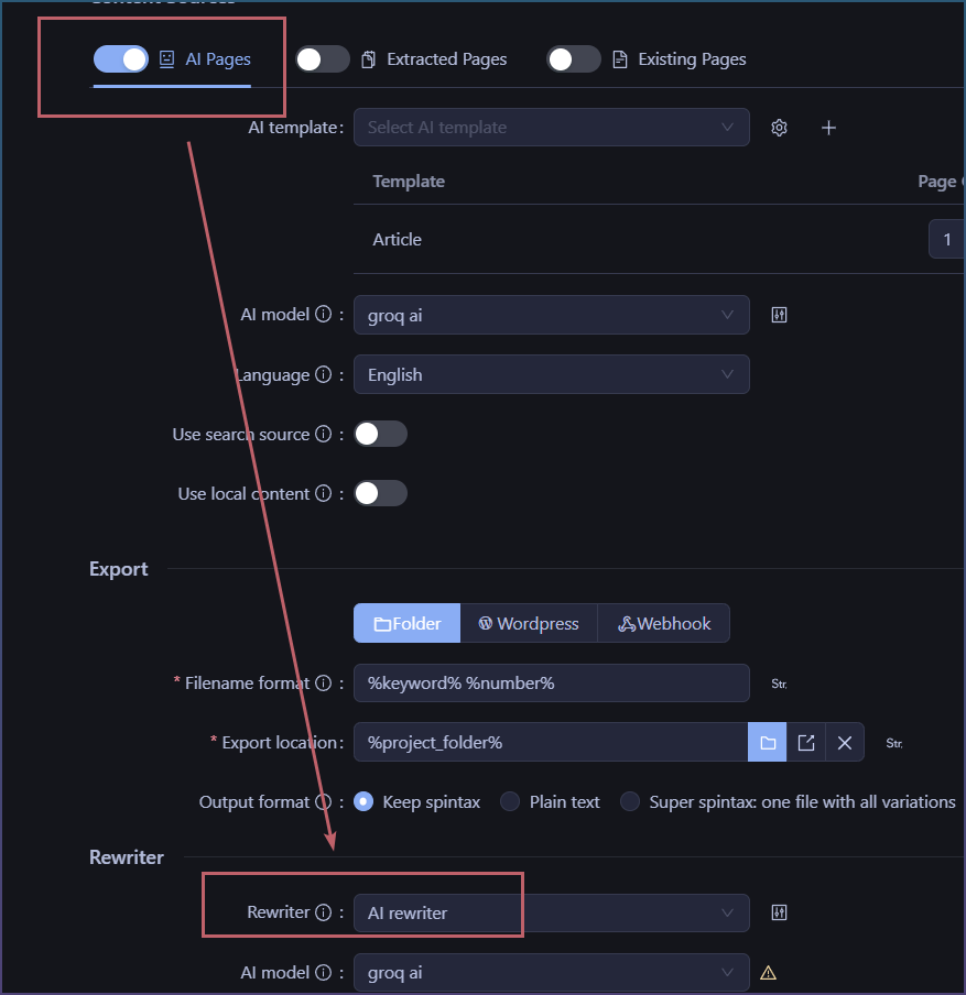

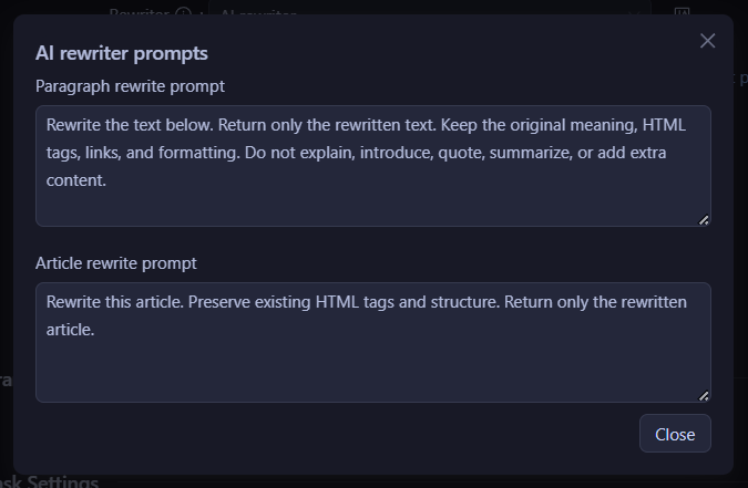

Ok I added new base prompt
Which gets used automatically when ai page is true and ai writer engaged.
Verify,

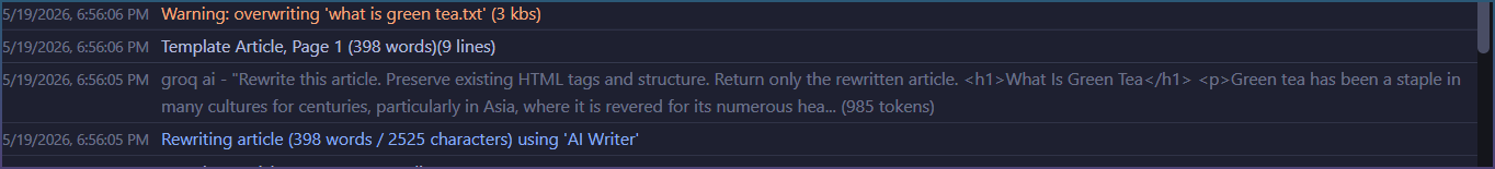

Look at log and see prompt is correct.
Update: whole article in 1 prompt
The AI rewriter now sends the whole article in 1 prompt, using the ‘Article rewrite prompt’.

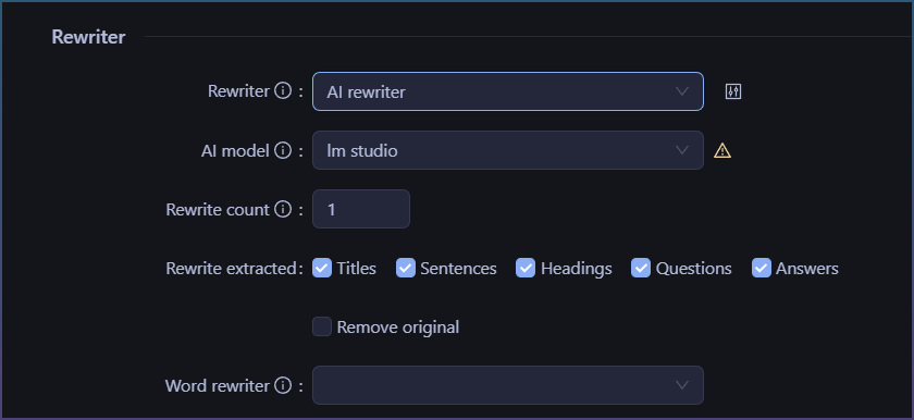

This works in RSS & Sitemaps, Rewrite & Translate, Search & News and Page Pipeline ‘Existing pages’.
There is no toggle. Only Page Pipeline ‘Extracted content’ still sends chunks of about 250 words.

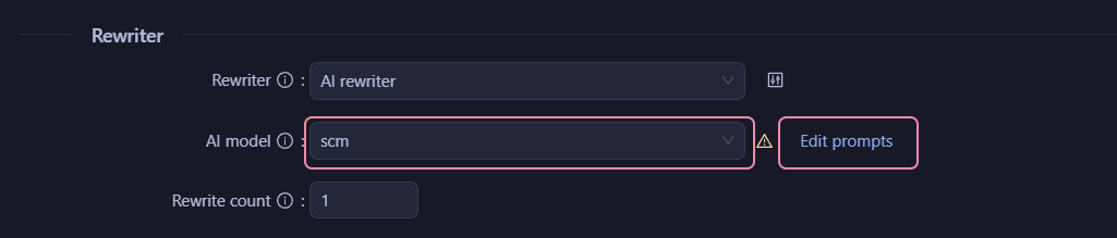

The prompts now sit inside the task too. Click ‘Edit prompts’ next to ‘AI model’.

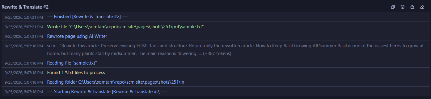

The log shows 1 prompt per article
Can the AI rewriter still rewrite 1 paragraph at a time?
Only in Page Pipeline ‘Extracted content’, which uses the ‘Paragraph rewrite prompt’. Every other task sends the whole article.
Which AI model does the rewriter use?
The one you pick in the ‘AI model’ field under ‘Rewriter’. Each task has its own.
