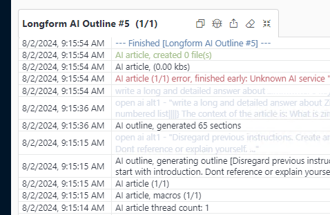

AI article (1/1) error, finished early: Unknown AI service
Getting “AI article (1/1) error, finished early: Unknown AI service”
This was after it already connected just fine within the same task and completed an AI task.
SEE SCREENSHOT
If you look at the screenshot, you will see it connected just fine to my AI instance .. but then, it said the AI service was unknown in the same task run.

Yes its the : that appears in the prompt that is tripping up the detection.
I have a patch for it, the service must match an already specified list or else it ignores the parsing.
Here is a screenshot …
Thanks, as I thought, its finding the : and anything before it is getting parsed as ai service name.
I found a fix, the service name must match a predefined list or it goes back to treating it like a normal prompt.
uploading a patch right now!
